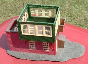

OK, I'll bite, starting with this pristine example, complete with no roof, no steps and plenty of goopy glue in the windows. Since I've always wanted one anyway, I'll just use the missing parts as an oppurtunity to personalize it for my road.

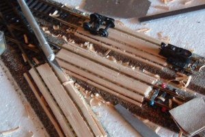

After a bunch of Awana Grand Prix cars and with a serious deadline looming, I'm finally up and running. Because I needed a junction to justify the tower project, I'm building onto a two foot module normally used as a duckunder on the club's portable layout. It represents Matthyson, a sleepy point on the map where the B&MC and CSX meet at a crossing. Shown here is the beginnings of the rail and road crossing points done in Campbell ties carefully trimmed to rail top level and spec'd for clearence.

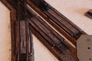

Once tested (and tested and tested and tested...long trains are pulled thru here), I pressed a nail point into the ties to represent fasteners then stained it with a black felt tip marker. I simply sanded the tops until I was happy with the patina.

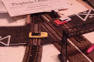

Finally, I cut and fit asphalt shingle material to represent roadway. It's fairly easy to use and makes a very convincing roadway once weathered. I've started marking the roads with paint pens. Blast...I'm outta yeller so I'm off to Wally World...

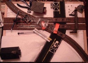

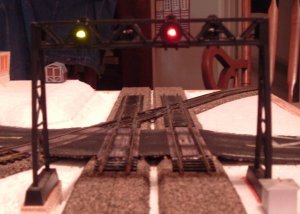

An overhead view shows where the Atlas tower goes in relation to the other elements...

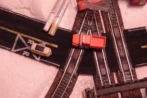

I'm pleased with the roads, a detail that I've dreaded in all my model work. This time (and from now on) I used a product called Painters by Elmer's, found in the crafts section at Wally World. Using a thin metal straight edge, marking was a snap.

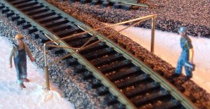

Because the B&MC is a class 2 branchline, signaling is an unnecessary expence. However, some means of traffic control is a must where the B&MC crosses the CSX main at Matthyson. Like other small roads, crossing gates or "smash boards" are used to control access to the mainline. The CSX guys in the tower must clear the train before the engine crew can unlock the gates, move the train thru, then relock the gates. B&MC crews are to never leave the gates unlocked at any time. Because of the footwork involved, the move can take upwards of 20 minutes hence the final authority lies in the hands of the tower crew. Our crews take delays well though, they're paid by the hour and the tower guys have a shaded table and soda machine to help pass the time.
Here the smashboards have been installed, made from brass wire...that...can...get reeeeally hot...if you're not...careful...soldering.... :eek:
