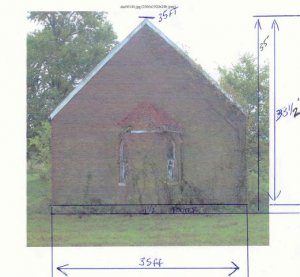

This picture is a project that I'm suppose to be doing for our family. Its a old abandoned church my great grandfather built. I'm planning on HO scale but the brick work is awesome. Hard to mimic in Ho scale. :cry: Kind of a rough example just to give you an idea.
philip

For example, the Church above is 35' x 33.5', in N scale that would be:
2.625000 inches x 2.512500
