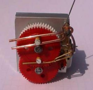

I designed and built my own motor driven mechanism.
The main requirement were:
Slow motion
Enough power for PECO and Scale 1 turnouts
Small in dimension
No limit switches (to avoid diverse problems).
Simple operation (DCC compatibility).
Now my switches (over 25 units) works well on 2 layouts. The operation is a single pushbutton - every hit alternates the position.
