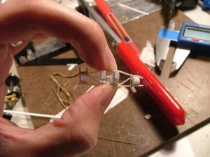

I've decided to save money by building my own trucks. On3 trucks cost $15-$40...so I can save some serious cash by building my own.

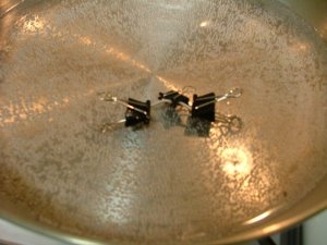

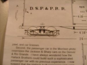

I first had to figure out how the trucks worked...which I did and then began my first effort using brass & styrene. The first effort is covered in this thread: http://forum.zealotmodels.com/t153515/

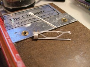

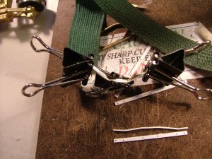

After that, I then sat down and did a few calculations on where to drill holes & bend the side frame irons. I decided that I'm too lazy to drill through brass (I don't have a drill press...or even a vise), so I decided to use styrene instead. I started out by measuring out and then drilling holes in the bottom piece. I made a mistake with the length measurements...so I market those holes with red ink. I then cut a second piece to length and used the first as a jig to help me duplicate it. I used 0.020"x0.060" styrene with #77 holes.

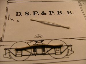

Next I bent a piece of brass to match the contour of the top iron of the frame. I then followed the exact same procedure for the top as I did with the bottom...without making any mistakes. I then clamped a piece of styrene to the brass and let it hang out in some boiling water. Afterwards, I removed it from the brass.
Lastly, I formed a piece of brass to match the contour of the middle piece...and then repeated the procedure of the top piece...but without drilling the holes.

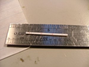

The results thus far were decent parts for the frame. I then formed the journal boxes from 0.125" x 0.156" styrene...filing the front to shape and drilling the axle holes. I then filed grooves into the sides to accept the "bolts" which keep the sides together. I then drilled the holes for one of the journal boxes at one end of the middle frame iron.
I next slid brass rods into those two holes, and glued that journal box to the bottom frame iron...and then to the middle and top irons.

Next I glued the other journal box in place...and then figured out that when attempting to put the top of the frame into place...it distorted the frame. By checking the wheelbase...I accidentally used a bottom frame that was 4" too long...so I had to cut it free and then move it to the appropriate spot for a 4' wheelbase. This fixed the alignment issue and I drilled out the middle frame iron at that journal box and glued the rest of that end together with brass wires in place.
Next, I glued the center of the bottom frame to the middle frame and drilled out those holes too.
Since no one really knows exactly how the bolts were fastened on these trucks...I've decided to just leave the brass wires in place to act as headless bolts. I can always come back and add head later without any difficulty. I trimmed the "bolts" and glued them into position.
Currently, this master is sitting in an RTV mold which still has 6hrs left to cure.
This does not include the center assembly for the trucks as I intend to use these castings in three different varieties of trucks...and I intend to scratch build each of these different truck bolsters/beams for each truck I produce.
Next up is a 3'4" wheelbase Colorado Central truck...and then passenger car trucks...probably 5', 5'6", and 6' wheelbases.

Ouch..!!! That looks harder than heart surgery...!! Great job..!! Did those trucks take some sort of springs...or did they just rely on the normal flexing of the truck..??
Keep posting progress pics...Very interesting how you're doing this..:thumb:
These had rigid sideframes which were mounted to a pair of 4x8s...these had a "spring sandwich" hanging in between them...which was how they were connected to the car.

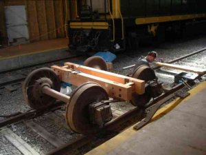

Miles, that isn't me or my project in that picture. That's a picture a website I thought I'd linked to in this thread...but I guess that I only linked to it in my boxcar thread.
http://www.spcrr.org/NARFGrantWheels.html
I posted it because it illustrates what I mean by a spring sandwich hanging in between the transoms that run between the sideframes. Sorry for the confusion.
