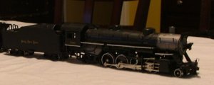

Updated Photo
Here's (yet another) bad picture of my Mikado, with some repairs made:
I bent the boiler stay from brass wire, as Doctor Wayne suggested, after installing the new pilot. I also had to add a grab to the tender, and I seem to have lost a tender marker lamp.
I added tender pickups, and installed a Soundtraxx steam decoder in the tender. I replaced the yellow LED with a golden white one.
It needs more tweaking to run better, as it will short out at low speeds while navigating some turnouts, and the pilot truck still derails on less than perfect trackwork. Could use more weight, too.
I also need to add a doghouse to the tender, Pyle headlight and Frisco Coonskin Headlamp bracket, a delta truck and a booster exhaust, marker lamps, and a smoke density lamp and wiring. I suppose I could add a Lima builders plate, too.
