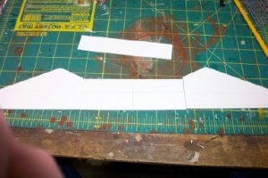

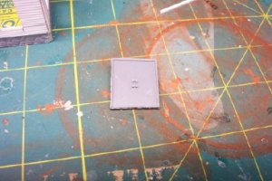

I picked a single floor design for my project. Of course the first step is to cut the walls. I used my favvorite medium-plastic. Its easy to cut, and all the popular plastic cements can be used. I used Evergreen Styrene Sheet, # 4061 Clapboard siding.

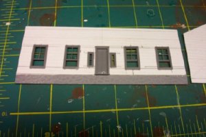

Next I cut openings in all the walls and fitted them for Tichy windows(Look for my review in the January E-Mag issue). Since homes were built on fieldstone foundations in the 1700's, I used Plastruct fieldstone, laminated on a .040 sheet of styrene for the foundation. It was painted gray form an earlier project.

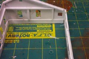

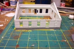

After all the openings for the windows and doors were cut and everything fitted, I assembled and squared the walls. Since the clapboard sheet was only .030 thick, I rough framed the walls for more strength and give some support. It was here, that I rounded foundation corners by sanding them.

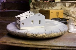

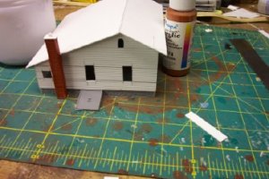

Here the roof is tempoarily fitted so as to check the placement of the chimney, which was made from spare DPM pillisters, capped with a styrene cap and a short section of tube.
Next up: Prime, paint add windows and place on the layout.
Watch this thread fro more developments.

After test fitting the roof, I painted the whole house primer gray. After that dried I masked the foundation, and gave it another coat of primer. This is SUPPOSE to seal the tape, and prevent paint from bleeding through the edge.

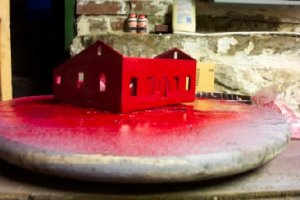

When the second coat of primer dried, I then put on two coats of Barn Red, waiting for the first coat to dry before shooting the second coat.

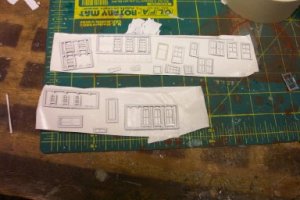

While the house was drying, I then painted the window frames and doors Gloss White.I stuck the windows to the sticky side of masking tape to prevent the parts from flying everywhere. Hint: Make sure you place the windows the right way on the tape.(Experience is the best teacher...We'll leave it at that!)

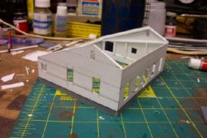

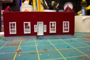

After the paint had dried over night, I then installed the windows and doors. As you can tell, that idea of spraying over the masking tape to seal it didn't work all that well.
