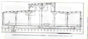

Here are a couple of drawings from CPR archives.
The dimensions may be too small to read but the front facing the turntable is 21.6 feet high and the door is 17feet high
