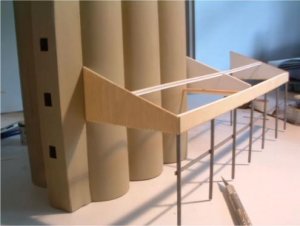

Guys,
Hope you can provide me with some nifty ideas here.
My latest project is a wheat silo, and loading dock. But I've got a bit of a problem with the roof. (pic below).
The cylinders (silos) are 255mm in diameter, and the roof of the loading dock is at 65 degrees from the perpendicular. (20 degree slope).
I need to cut some pieces that will fit slugly up into the silo cylinders, however, the cut out piece will not be semi circular, due to the angle of incidence with the cylinders. (they'll need to be cut in a semi "elipse".)
Truoble is, I've no idea (other than hit 'n' miss) how to get a good cut and fit for it.
I'm going to use corrugated iron (not real stuff), and its actually metal (aluminium), so I really need it to be very accurate. One slip and the whole sheet is wasted really.
Any ideas? If I have some 3D modeling software etc, I could do it, and print off a template, and use that, but I don't have the software.
I've thought of using some very thin card, hit 'n' miss cutting to get it right, but I'm sure there's an easy way of juggling "something somehow" to get the curve I need.
Any help is really appreciated.
Thanks.

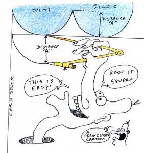

Hi Woodie
We have exactly the same problem when making log cabins and the solution has been around for years. The way it's done is with a compass, but you don't use it to draw circles with.
Best way is to make a templet on card first, then mark out your tin.
Place a bit of card on the roof so it lays right against the silos. Judge the distance from the most inner point, in the V between the silos, to the edge of the cardbord. Make your compass this same distance. Now keeping the compass point and pencile point square with the edge of the card is the hardest part of the next bit. Put the point of the compass at the edge of the silos and the pencile tip on the card. Now trace the compass point around the silo, keeping it square, and draw a pencil line on the card at the coresponding spot. You will draw a pefect copy of the shape.
Carpenters do this when they install moldings around the corners of cielings as well. This is also how to transfer the shape of a tricky floor tile.
Leave the mathmatics to the mathmatitions.
TrainClown
I'll Draw what I mean
Just think that the compass is straight up and down and not laying down like this one looks. Distance "A" would be the farthest distance the pattern has to duplicate.
Hope this helps.
