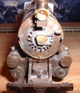

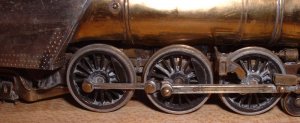

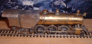

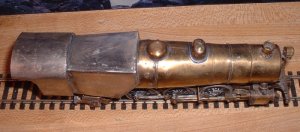

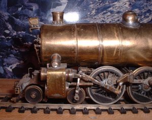

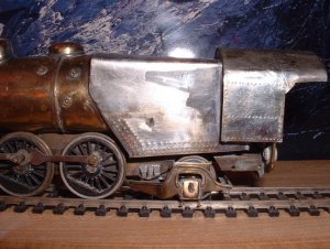

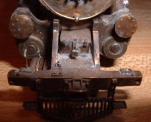

Here are a raft of pictures of the K4 as it now stands . I'll try to explain some of it as I post them.
First order of explanation--- I have NO IDEA NOW why I put the cab on BEFORE I put windows in it , can't even think of a good excuse, guarantee it's going to test my skill with a dremel & a cutoff disk to get them in now. You will notice that the fire box & cab are not brass -- I became aware that the Limeys ----oopps --- I mean our beloved brothers in the UK do a lot in Nickel silver so I thought I'd give it a go -- turned out to be a jolly good show chappies!
Mels attention to detail knew no limits, the little round gizmo on the exhaust pipe just above the cylinder was a "snifter valve" whatever that is, but he modeled it, I never heard of one but I built it too.
Compare the side rods from one side to the other, one is finished -the other has to be completed, Mel cut out the blanks finished them to size & then soldered strips on them to form the flutes, I thought about using a Special Shapes "I" beam brass stock but elected to do it his way!
Mel also made his trailing trucks from scratch-- so did I -- If I could have found one that matched I probably would have used it -- that was a devilish build!
So far about the only thing you see so far that are commercial detail parts are the washout plugs & the stack --- Oh yeah the pilot, I had one lying about so I skipped that job.

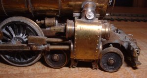

Rats!!. Last night ,right when I hit the post button to put up the rest of the pics of this engine was when the server change hit!
Here they are .
I even made the little bitty padalock on the tool box that Mel put on his.The brake shoes & cylinder on the lead truck were made according to Mels instructions. The Pennsy number plate & headlight are castings, but Mel made his own. You can see how well his built up side rods turn out in one of these pictures.
As I finish this project up , I think I will use a few more commercial detail parts, generator, bell , whistle , compressor etc. as I have reached a point where time is more vaulable to me than proving to myself I can do any given job. I'm even debating if I should build or try to locate a correct tender for it.
