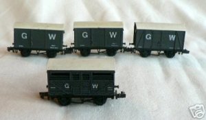

Oh, and I have a 0-6-0 tank loco and some very short two axle cars on their way.
They're by Graham Farish, British prototype (which will probably look awful as the loco I got is German prototype, but some paint and modifications should make them look good enough)
Oh, I thought maybe you had found some short passenger cars.
