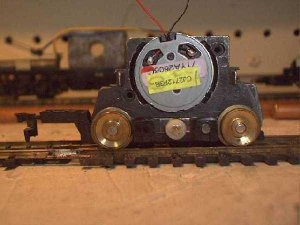

I've been considering building a battery powered RC switcher. Haven't got around to it yet, (too many other projects). :rolleyes:
The plan was to use the electronics from one of those Matchbox size RC cars powered by batteries that are recharged from the track voltage. A 3 volt motor from a cassette player would replace the 12 volt motor of the loco.
This is one of the 3 volt motor transplants I did.
