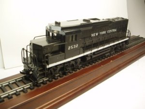

Athearn made GP30
I have some Athearn made GP30 that has not been produced for a long time. I think Irvine Athearn didn't want to make two similar locomotives and when he released the GP35 he had the GP30 production canceled. I have this one in factory paint and 3 others . One more in NYC and two I painted in PRR.

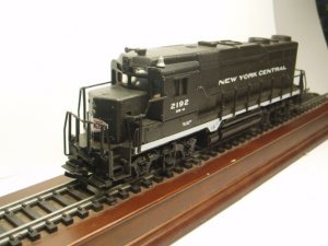

A Bev- Bel GP30
Here is a odd ball GP30
This 30 was custom painted and released by Bev-Bel. It uses a Bachmann body and details. And a Athearn drive. It came in a Athearn box with a Bev-Bel lable.
