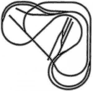

I have decided that since I have been talking about changing the trackplan, I will. I was at Hobby Lobby today, and was looking through an Atlas trackplan book. I came across one called Rancoca's Harbor Belt, and though I will give my hand at this one. I like the track plan. It is more or less a loop (two loops make up one full circuit), sidings, a small yard. It's all good. Now to go and dismantle the layout I have now, not that it'll be very hard to do, there isn't much there
Tried to use HL as a library, but ended up buying the book. There is just too much to the layout to memorize, and it even describes how to set up the benchwork, the wiring, and everything. Even has a supply list for all the track pieces needed, switches needed, etc.
I've already started to dis-mantle my layout. I'm in the process of removing the 2x2 patch I added in the walkway gap. As seen in the pics, my layout is 2 4x8s, with a 2x4 section cut out of one. The remaining 2x4 section remaining will be cut off to make a 4x8 with a 4x4 L
Steven, GLAD you found a trackplan you like!!!:thumb::D . are you staying with BN? or are you changing era and roads? what are your plans? :D -Deano
Sticking with my BN loco. I do have a Dodge Viper to put on the layout, along with a 74 Ford van, and a BN semi. Those 3 alone would make it modern (well, the Viper and the semi anyway). I will be sticking with the shorter lengh cars, as the trackplan calls for mostly 18" curves. I will try to get a pic scanned of the trackplan from the book its in, to post it up here.

Steven, THANKS for answering my questions:thumb: . Hmm, 18r and you want to stay with a BN era layout, 50' boxcars WILL make an 18r curve, that will help make it look "modern". Harbor, thats something you will have to decide, i haven't seen the trackplan, so i really cant tell you what I think;) . i am "old school", i have ALWAYS done layouts cookie cutter, i have never used foam. i only solder the curves, i always thought you had to keep some track NOT soldered for expansion and contraction? others might give you better advice on that;) . ONE THING, i personally have NEVER had good luck with #4 switches:( , i suspect the layout plan might call for them. when i "use to" use #4's, i used Atlas code 100, perhaps there is another brand that makes better ones so you wont have problems. when it comes to trackwork, i HATE that part of the hobby, and am BY FAR NOT an expert on that:( . i hope others will chime in with good advice for you:thumb: . you have a lot to think about, GOOD luck with your new plans:thumb: . i WILL be checking to see how you progress:thumb: , keep posting pics!:thumb: :D -Deano

I don't recall off-hand what type of turnous it calls for. I'll have to double check, I don't even know what types I have right now. I'm guessing #4, but is there a way to check?

I think you should try and figure out a way to fit larger curves in there. Whats the overall space you have to model?
Also, you can just have a bunch of barges to be loaded without outragous amounts of ships and space being taken up. I have made a layout plan like that before.
Steven,
If I recall correctly, some of the Atlas plans on paper actually did not fit right in real life. I remember reading something about using flex track in most places instead of the curves suggested.

Is this the track plan?
Do I build it cookie cutter style as the book has it (cheaper), or go buy risers and inclines?
I would like to lay foam down under it this time around, probably with 2", so if I do go with the harbor, or even just any water for that matter, I can carve down from the track level
These are strictly MY opinions as a novice;)
If you're going to use blue or pink foam as a sub roadbed I would dispense with the cookie cutter method and use foam risers (great product and easy to use).
The answers to many of your other questions, about the harbor and such, will become clear as you progress and SEE your layout unfold. I think you should PLAN on a harbor or at least a pier or two....If you later decide you don't want it....you can just scenick it as a hill or houses or something else.
#4 turnouts.....Deano's right about those...if they can be avoided, do so. The same goes for small radii. The problem is...they're not usually a choice (without considerable compromises to your track plan). My layout has about 14 turnouts...12 are #4's. I have not had a problem with them but if I had the space I would have liked to use #6's.
Steven, It's like anything else...one step at a time....and have fun!:thumb:
Post that pic of the track plan with harbor and other feature locations.
