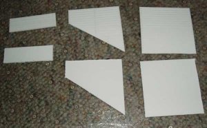

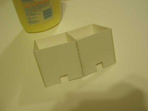

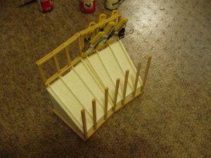

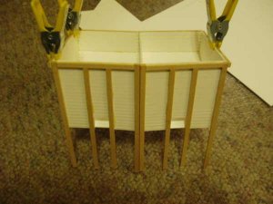

I decided I needed an ore tipple for the ore cars that I am building. Here are the beginnings. I am using illustration board I had laying around from other projects and some scrap wood. The illustration board has been scribed to simulate planking.

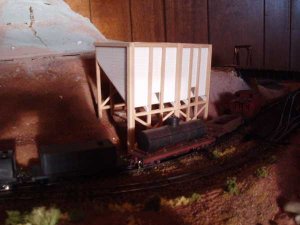

here is the basic tipple in place on the layout to see how it fits...

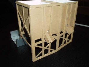

I've got some paint on it, and most of the main structure done. I've aded ore chutes and some bracing. I need to figure out how to make doors for the chutes, and the associated lifting mechanisms. And then comes the task of figuring out how the tipple will be loaded by a 30" gauge track...

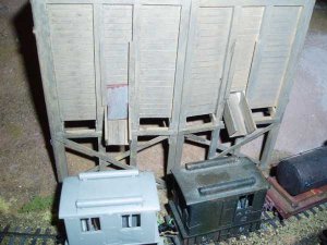

here is the latest...I'm not quite sure where to go from here. the ore chutes need some sort of "gate" and pulley system, and probably some kind of extension chute so that the ore can actually reach the cars. I am not sure exactly how these things were built. I could either do more research, or make something plausable that looks good. I've already experimented with a "steel" gate on the left chute, thinking that it would slide in some kind of runners, and would be raised by a pulley and chain. Anyone have any ideas?

AS for your chutes you could probably copy a coaling tower's gates and chutes.
I have seen an interesting chute detail while exploring Victor CO a few years back. The chute was wood based, but lined with sheet metal. There was a bar that ran across the top of the chute, which had 6 or 8 short chains (3ft, maybe) attached to it. The free ends hung/layed in the chute. I assume they were used to control the flow of the ore as it rolled down the chute(s) and would be an interesting detail that I haven't seen on any models.
