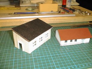

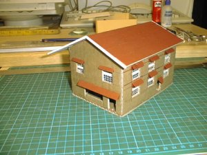

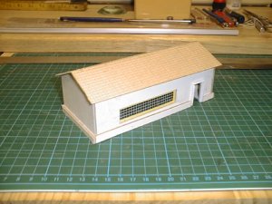

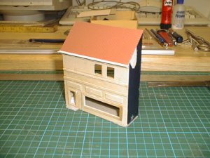

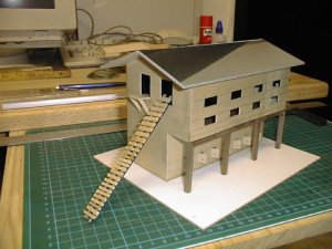

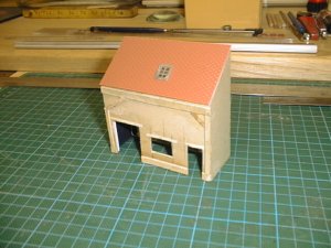

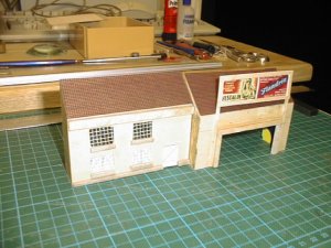

This is a lot of pictures from my second try , nothing very spécial , but it start with scartching last week for the first time !!!! ( hum !!! )

Nice work and a great tribute to the tradition of carboard scratchbuilding that Robin excelled at and shared with us. Your English is fine by the way. Welcome!

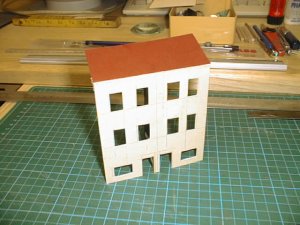

I have make to day a other scrach buid test with these infos ... mutch better to work ( doors , windows ,cars !!! )

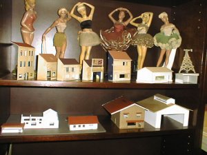

Mr. Fly, your modeling and English are both quite excellent! And what better way to display your buildings than beside ceramic chix in mini-skirts?
Why didn't we think of it!
Why are you having trouble with the scale? Is it the math? Is it conversion of prototype (1:1) to HO (1:87)? Or metric to standard to HO (what a mess that is!)? or ??? I hope I do not offend you by asking! If you don't already have one, a "scale ruler" is a must! It is like a regular ruler, but it shows HO feet instead of inches or centimeters. If you are going from photograsphs, this howto may help: http://www.2guyzandsumtrains.com/Content/pa=showpage/pid=35.html
(originally a gauge howto, then the pics died when my website died, then my friend took the time to fix it up for me).
Inneresting the different roofing materials, could you expound on how you do the roofing? :D
I don't have any ceramic chicks, but i can probably get my girlfriend in a Mini-skirt to model some of my models...does that count? :D
Very nice work with the cardboard too, Flytox! While i still prefer styrene (easier for me, i guess), i've always been amazed with what some people can do with paper products!
