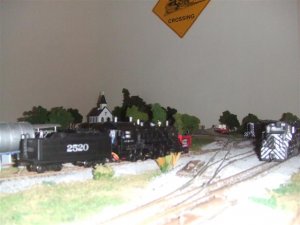

Personally, I'm with you on the Spectrum 2-8-0. It has to be my favorite locomotive in the small fleet I operate on my 4x7 HO layout. I equipped it with the plug-in Soundtraxx Decoder and DCC, and it's really an attention-getter.
I wish I only had the skills that our friend Doc Wayne had to add some handy details. I still have the default color wiring, mainly because I'm not the rivet counter type of modeller, although I've been thinking about really spicing this locomotive up.
But I've been very impressed with its performance and it's realism. (I've had it for about, what, 2 years now?) It's also a steam locomotive the PERFECT size for my layout. Here's a picture, albeit it's probably a year old or so when the layout was still in its late-early stages.:wave:
