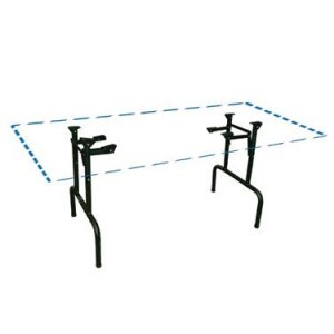

Is this going to be a self standing table or the one that is going on the dining table in your garage? If it's the one going on the dining table, you don't need legs. just cut notches for your wiring. If it's going to be a self standing table, get a set of these folding table legs from Northern Tool
