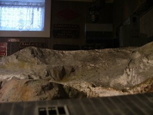

One Layout Picture!
I am slowly building a layout and you can see videos at: My YouTube Videos.
Kind of went overboard with hydro-cal rock castings...I am going to tone down the hill on the right and put the town in that area.

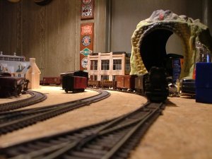

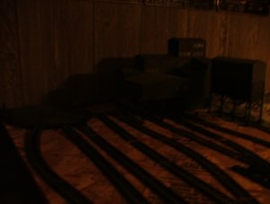

I've attempted a few different techniques for mortar lines. IIRC, I preferred coating it in powdered white chalk...running a damp something over the bricks, and then weathering the rest of the sides prior to dullcoating it.
I've been told by a few people they age their buildings with Chalk and pastels. I've never seen this done, any photos? I'd be interested to see the end product.
These are HO, but here's a trio. The backshop is not as white as it appears in this picture. The coal mine was also difficult to photograph...with only the black chalk showing up in the pictures. The coal dock looks about like it does in person, and you can see a pair of chalk weathered Silver Streak cars under it.

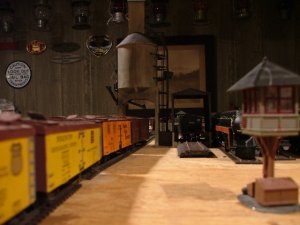

Thanks. My dad used to have the walls lined with lanterns. The walls of the train room were covered with builders plates, padlocks, and other parts of the basement have builders photographs, a bell, and even a whale oil headlight. It makes for a very railroady environment.
The spot lights are missing, which makes pictures of the coal mine difficult. Here's another angle of it.
