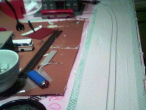

Main Street repaved
Ok,I did get alot of shopping done early,and I happened to be in Home Depot.....

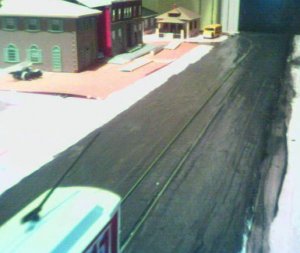

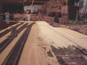

I reglued the track down last night so it would be dry today.I removed the tpins,built barriers out of double sided tape.The length across is 6" just wide enough for my tool.I tested all trolleys and they made it around numerous times.
I then began the "smoothing" of the speckling.
The stuff "sets" quickly and the more you mess with it,the worse it looks.However,no road is perfect,specially in Boston.Should I mention Type 8's?
It looks alot like the joint compund,and there looks like there will be a need for a second pass,maybe not on the inside but outside of rails.I used and old set of boxcar wheels to make a few passes,and rough it out some. Hopefully with a second pass,it will disguise the ties a bit more.I have decided to use and asphalt color(greyish black) to hide the ties too.
Defintely looks as if the other roads(on both modules) will be in quickly.Then a little bit of sanding,and some paint and I should be ready to ballast the exposed track,and lay plaster cloth.
I don't have to be back to work til Jan 3 so I hope to make some more progress.
Here's some photos.You can see it already looks better than the joint compound did.

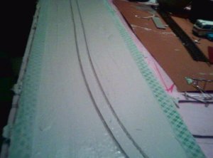

Again,this morning the ties are more pronounced,there are cracks,etc.....:curse:
Its gonna need a second coat.The rails are cleaned and Im getting contact but I am discouraged by the look at this point. A little "sunken".Should I be doing it in smaller amounts? Maybe a small section at a time,sand,clean,lay next section,etc.
Im also considering balsawood inserts for the middle of the tracks.The plastering method seems ok on the outside part of the rails,but in between is the problem.
Anyway,Ive got loads of flexi track and I am not adverse to ripping it all up again. **sigh**

I wonder if it has to do with the thickness of the layer - could it be that it needs to be laid in several coats and allowed to dry out SLOWLY in between? I seem to remeber that there is something that can be added to slow the setting time. I think balsa might be a problem due to it absorbing water and then swelling!

It is in the mixing, must be.
I test the mix using a knife if it slops off thicken the compound up, it has to hold on the knife.
The pics of our road was all done in one go, with no problems.
I use balsa strips about the same hight as the rail , I pin them where the road width will be, allowing for side streets as I go.
Then I mix and pour mix and pour untill it`s all in.
Using a pice of wood the lengh of the street I glide it across the rails balse wood to balsa wood, this will push the excess as I go into the area to do next, have a pan of water to keep the wood clean.
so as it`s drying the top rails are just about showing.
When it`s dry I use a jewlers screwdriver at an angle against the inside rails and a set of wheels to check for contact..
I dont try for a smooth finish untill its been down for 15 mins otherwise you will thin out what you have just done and weaken it .

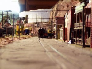

Here is a shot of the last street I did on my old L/O.
The last shot is the finished scene.

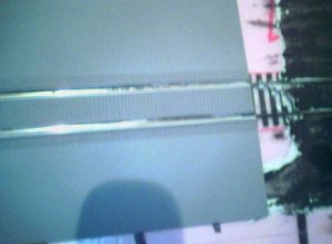

I decided to paint it and see what it looks like.The trolleys all make it around!The track needs to be cleaned a little bit better.I will do a second coat later tonight and try to darken it a little.The ties are much less pronounced.I think with a little scenery...hell you may not even notice it.I like the blacktop look anyway.

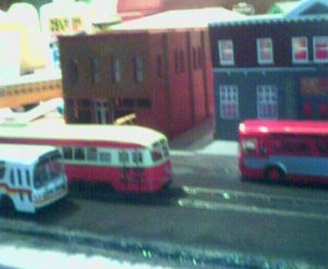

On that bus...do you know who manufactured it.Looks to be maybe MEK or Pirate. I would definately grab one if I ever saw it.

The street track looks ok today. Im still thinking it will need another coat as it still looks bumpy around the rails.Can I mix the topcoat right into the speckling compund or should I just lay it wait and then paint it?
On the mix-can I add water to it if the speckling seems to thick?

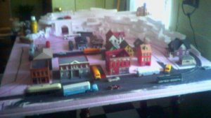

Im really waiting at this point for alot of prebuilt buildings to arrive.16 in all,that should help fill in some of the dead spots and replace some of the less desireable structures I really don't want.
Since the whole layout is based around the buses,Im looking to place the bus station near the front of the layout.
This poses several problems at this point but I think once the buildings arrive,I'll be able to get a better vision on where to lay more streets.

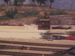

Here's a mock up.The area in the back infront of the portal,is the area I was going to put the bus station in,but I'm afraid with the hieght of the new buildings going in,it may get lost in the skyline. Im now thinking where the small school bus is turning of locating it there.
Alot of the buildings shown will not make it onto the layout.On the far left you can see where the other street trackage will go.
