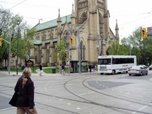

Here is a pic of real tracks :D Code 83 NOT!! :D

Actually the first photo is what Im trying to acheive,minus the RO track:D
The curve is more gradual with the flexi,but it's ok with me-as long as it works.
