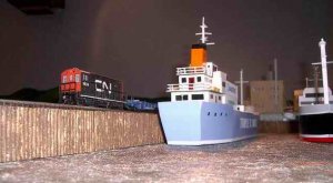

I don't have a Track Plan on paper but maybe I could draw something up.

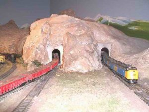

My scenery is still needing some greenery and especially lots of trees.
I think that I will wait for warmer weather so I can make the trees on my patio table outside and avoid the fumes from the spray glue.
My next job is to finish off a small lake which is at the left of the roundhouse.

wow really nice layout look foward to seeing more,but you might want to put the f units wheels back on the track it seems to have derailed :thumb: :D oh btw nice layout glad to see some canadian stuff :D:D:D :)
wow really nice layout look foward to seeing more,but you might want to put the f unit's wheels back on the track it seems to have derailed :thumb: :D oh btw nice layout glad to see some canadian stuff :D:D:D :)
It looks like the front wheels are off but the engine is acually branching off left into the passenger station track.

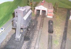

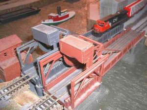

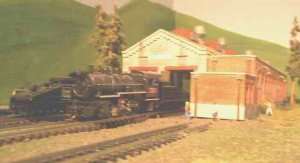

The first one is the 2 stall engine house at the east end of the town. It services the east end of the yard.
The 2nd one is the main line entrance to the docks over two bascule bridges.

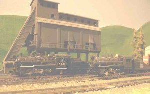

The two steam locomotives at the first picture just looks great :)
They seams to be old due to the weathering. Could you give us a closer picture of the locos? Please:wave:

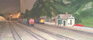

Made a close up of those steamers you wanted and added another photo of my Big Boy and Challenger in the Roundhouse Yard.

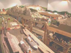

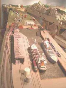

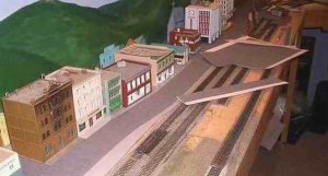

In the 3rd photo I tried to get a shot of most of my layout. I have just added the floor of the docks and still intend to add more admin buildings.

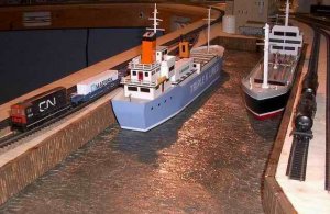

Greetings Denyons from your southern neighbor in Montana. Question for you. What did you use for water? I've been experimenting with Woodland Scenics Realistic water but it takes forever to get to a cured state. In the meantime it collects dust and lint and slows down working in the area. Any suggestions?

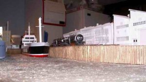

Hi Jim, For the water in my docks and the fast flowing river, I used Matte Medium which is available at Drafting and Art stores. It is a syrupy consist and you spred it evenly over the surface. You have lots of time to make little waves in it as it takes overnight to set.
I used the handle end of a spoon to flip up little waves. Of course you need to paint the base colour before applying the Matte Medium. When it has fully set I used some white acrillic paint from the local dollar store to whiten the tips of the waves. For this I poured some paint onto a piece of board and pressed a firm piece of pink styrafoam onto the paint to transfer the paint to the tips of the waves..Dont press too hard or you will have too much paint on the water.
One other note....try to spread the Matte Medium to cover the suface but don't make it too deep or it will dry to a foggy white.
