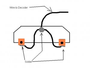

Russ, when I say "solder the bearings" I am talking about using decoder wire soldered on the bottom of each bearing, then that runs up to the sideframe. This leaves the bearings free to float just like they did originally. From there, we will use the "five-wire" system to the decoder.
Alternatively, the bearing wires could go directly to the decoder similar to the five wire system.
I've already done this on a GP-38 and it works great.
Ok, I misunderstood. Are you also using a short piece of decoder wire to connect the bottom of both bearings together before soldering them to the decoder in the 5 wire system?
I could see it working. You should be able to consist the decoders, under one address. The wiring should not be too much more complex, just some splicing. Might I suggest dummy couplers between the units though, to save $$.
I did the GP-38 like this. I could have skipped hitting the sideframe and taken the bearing wires directly to the decoder.

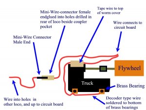

Follow-up on this project. Finally got it working to perfection tonight. Got the two locos matched for speed characteristics by adjusting the CVs, figured out the best routing for the wires to avoid binding the trucks or interfering with the mechanism, found some small wire conectors, and got it going after quite a bit of experimentation and reworking. The brass bearings have wires soldered to them and up to the circuit board which eliminates some of the "contact pressure" connections from the trucks to the circuit board. I ran them for awhile tonight, pulled some cars, did some magnetic uncoupling, I'm real happy with it now.
Essentially, my 2 CF-7s are MUed together and share all the wheels in picking up power for each loco. Yep, each loco is getting power from 8 different wheels per side. These are the CF-7s that I weighted with lead inside the bodies awhile back. So, now I have one bad-boy MU consist with good power pick-up that eats dirty track for lunch, no flickering lights, even when traveling over Atlas #4 turnouts, and these babies gots some mucho power!!!
Here's a diagram. I used black wire, shown in red for clarity.
