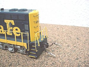

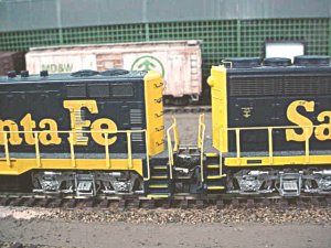

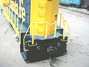

Here are some photos. Once I put some black paint on the exposed portions of the connectors, they will hardly be noticed at all. Since my openhouse is coming soon, I want to be certain that I don't have any power problems.

As it is now, I can only mix a "female" loco with a "male" loco. Not very politically correct.:cool:
It just dawned on me that I should have female plugs in all the locos, and then have wires with male plugs on both ends, then any loco could be attached to any other.
When I saw the photos, I thought that that's what you'd done: the first view showing a converted loco, the second view with the wires plugged in, and the final set-up in the third picture. ;):-D
I thought that all locos (and cars, trucks, and countless other "guy" stuff is always referred to as being female, at least by guys). And I have heard some women refer to their car as "he". Perhaps we shouldn't be parking them too close to one another, or we'll end up with a new go-kart in the garage. :p
Wayne
Wayne, it is all so obvious now, don't know why I didn't think of it sooner. Each loco needs a female plug because the locos are indeed female (Thomas the Tank notwithstanding). The connector wires get a male plug on each end. That way, I can remove the "maled" connector wires and run the locos as singles without the unsightly male wire dangling out. This has the added bonus of any loco being MUed with any other loco. I will do this tomorrow.
