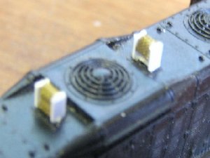

I think Tad & I have the spark arrestor nailed, I needed a couple as well, so I got some Evergreen I beam stock, (P/N 274) and a little brass screen and here's what I came up with. They are 1/8" tall and use the cast in base, just wrapped the screen up over the top of the I beam section and glued em in place.

After talking with Todd on email about how to try to make these spark arresters, this is what I came up with.
I used Evergreen .125" I - beam cut to .100" for the body of the spark arresters.
I used some Evergreen .010" strip to cut the base plates from.
These are the I - Beams assembled to the baseplates with Testor's Model Cement.
A finished spark arrester.
I cut a .010" thick piece from a .030" x .030" piece of styrene to make the ears that the MoPac version of these spark arresters have. They don't show up that well in this shot.
And now that we have done all of this I found out that JnJ makes a similar spark arrester.
It would still have to be modified a little to be like the MoPac versions.
