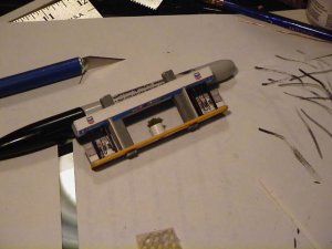

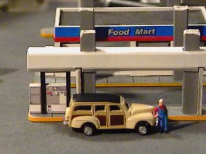

Here is another progress shot. The pumps are now 90% finished. Here is a zoomed in shot of one. All the needs to be done is: 1) make the nozzle housing for each octane rated gasoline, and of course 2) the hoses coming down from the top. Other details will be the squeegee compartment and perhaps some potted shrub in the center.
Sorry for the grainy look, but rather than the usual image reduction by 50% to 640x480, I cropped it to 640x480 instead, keeping the original zoom level. The Ford Woody is somewhat of an anachronism, but I don't own any modern true N-scale vehicles.
Railway Jim: $10 on the Ford Woody at pump 8
Attendant: Would you like anything else?
Railway Jim: Well, yes... where are the nozzles?
Attendant: Probably the same place where my store interior is at... still stuck inside someone's imagination!

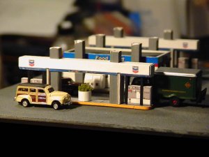

A progress note: (No pics yet) I'm thinking of using copper wire for the gas hoses... 20 awg stranded, separated... each strand measures 0.012" in diameter which comes out to approx 2" in N scale - seems about right to me. I hope it can take a coat of black paint without cracking... I will pre-form it beforehand.
Ok, the painting of the copper wire didn't work out very well. Instead, I took a black Sharpie permanent marker to it and it came out nice. Here is the finished pumps:

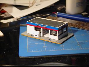

In this picture you see the interior of the store. I added the following items:
Refrigerator units along the walls
An aisle of "stuff" down the center
A counter with a "lift out" for checkout
Cabinets with a counter behind the checkout
I've also started putting the glass in. You can barely tell by the photo (the scratches on my piece of plexiglass don't show up in the picture) but if you look closely, you can see the reflection of the "ICE" box. I need to do the other side and then put the "doors" and I'm put little people inside and the food mart is completed.

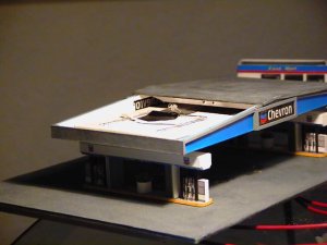

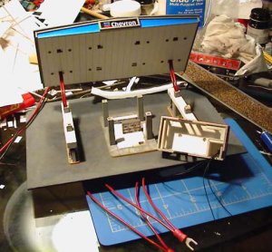

I know a lot of you are thinking "LIGHTITUPALREADYWILLYOU" and those of you who are anxious, here's a little look "inside." :D
I made "circuit boards" out of cardstock and inserted white LEDs. I folded down the leads for PARALLEL wiring of the LEDs. there are 6 LEDs underneath that poke out of the canopy and one angled LED that will backlight the Chevron sign. This is repeated on the other side and lights up the opposite Chevron sign as well. As I said before, I was disappointed with the incandescent light bulbs but now I can say I am completely satisfied with the LEDs level of brightness. The electrical tape is to insulate the top bulb from the leads of the bottom bulbs. Since they are "wired" in parallel, I only need one set of feeder wires per half, so a pair of wires goes through one of the columns one each end. The twisty tie you see is holding the wires in place underneath.
Another view of the backlighting of the Chevron sign. Since LEDs work like flashlights, it works out rather well and having room inside to place it at a distance enables me to light up the whole thing pretty well. Sorry folks... no lit pictures until the very end! :cool:

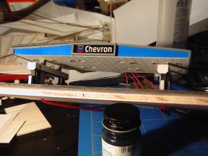

Here is a view from below the canopy, showing the 12 LEDs poking through little openings. Looking underneath the base, you see the feeder wires coming down the bottom and out the back. I put these feeders together into those "U" shaped electrical connectors, keeping everything in parallel. I will probably screw a terminal strip to the bottom of the base or to the module where power will be fed in. I still need to light up the interior of the food mart.

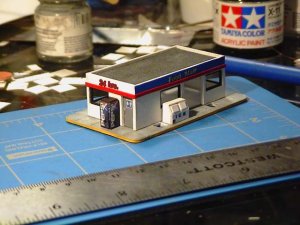

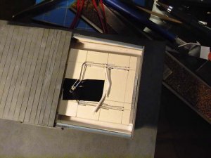

OK, I hope this is a better shot of the interior. Part of the interior is glued to the base, and part is glued to the structure, so if I separate them, you won't get a true feel of the things inside... hopefully from this picture you can.
Also, I've finished up the glass all around. I'm not 100% satisfied with the results and I have to admit that I got carried away with one thing or another and this aspect has slipped my attention. I think it shows. :(
At any rate, I did up on side of the building with the door to get in. I know someone was curious as to how I was going to do it. I pretty much did it the same way I framed with windows, plus I put little holes to allow me to insert another wire strand door handle. Here it is:

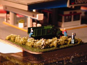

The sign will be exactly there, on that corner. I haven't decided how I'm going to go about it - it needs to be lit up... I'll cross that bridge when I get to it. For now, I still need to bring up the other walls and landscaping areas. I can finally see light at the end of the tunnel! (But with my luck, it's oncoming train!) ;)

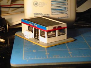

Well, folks... The landscaping is completed and I put in the price portion of the street sign (Chevron logo is missing, but it's already all over the place). There's a few things I would like to add to this model, but in the spirit of "moving on" I will leave those to a time when I can dedicate myself to detailing. For now, I dub this puppy "COMPLETE"! (WOOO! Never thought the day would come!)

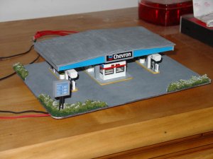

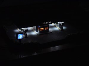

And the moment several of you have been waiting for... the "Grand Lit Finale" or better known as "LIGHTITUPALREADYWILLYOU" time. Gosh... I sure hope it lives up to all the hype! :oops: :rolleyes: :p
And last but not least, a closer up view showing the lights from underneath the canopy. I really am pleased with my new digital camera... this picture was taken in complete darkness and the light from the LEDs is nice and white. The yellow glow from the incandescent bulbs in the interior is very apparent in this pictures. Well... Enjoy! :D :D :D

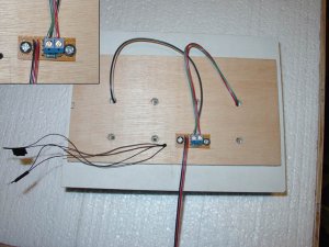

Anyway, here's an update: I put the components I got at radio shack. Now, with the wires going INTO the blue clip, all my LEDs are wired in parallel. Then FROM the blue clip, it's in series with a 470ohm resistor with the wires pointing down feeding DC power at 12 volts. So now, to change out a "light-board" I unscrew the little screws, take out the wires, and pull it out. I still need to figure out what to do with the 1.5v bulbs.
