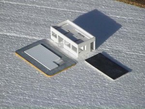

And how it comes apart...

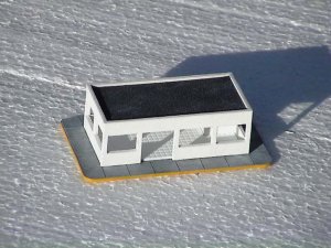

I've made the structure in pieces (This is typical of my modeling style - lack of commitment? Foresight? Who knows? :D )
Since I want to have lots of lighting, I've made a faux roof that will house the 1.2mm diam. light bulbs. The bulb wiring comes up through the square hole (over the restroom, which is completely boxed in) and through the roof space, and wedged into the supports over the openings in the ceiling.
The tar-paper roof is simply a painted piece of 150 grit sand paper glued to card stock. The parts you see in the photo will remain separate. The building will lift off the foundation, and the roof will lift off the structure - all for maintenance purposes - in case bulbs burn out. Not to mention, I need to detail the interior.
The sidewalk around the building is complete with "watch your step" yellow painted sides. :D

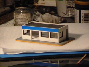

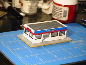

Made a little more progress.
Here, I've added a base of blue where the "Food Mart" lettering will go - I didn't worry too much about the edges, as I plan to put some molding where the white meets the blue.
Also, I added window trim. I used 1/32" basswood striped painted "Gun Metal" (my favorite paint color!) and "mitered" the corners at 45 degrees. No glass yet, that's coming soon. Need to put a restroom door and glass entry doors.

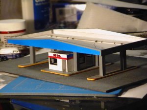

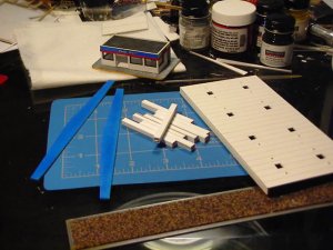

Here I got a tiny bit more progress: I made the "ceiling" of the canopy and the 8 columns that will hold it up. I made the columns as an "L" of illus. board and the other half of posterboard. I did this for (1) strength, but (2) I needed them to be hollow. I will run the bulb wiring through these columns. The little holes you see will be light bulbs. I didn't put as many as in the photo, because they are 70 cents a piece! I will need lots of bulbs when all is said and done. :p
The blue "pentagons" are the sidings of the canopy. These will be glued over the supports there now. Then, I will have the roof be removable, as well as having the entire canopy able to be lifted off, so I can get to the food mart below it.
Originally posted by RailRon
Now I'm wondering how you'll going to wire up the canopy bulbs and still leave the canopy removable...
Very simple: I am not going to glue the columns to the canopy - only to the base. The roof on the canopy will come off to service any bulbs on the canopy, but if I need to get to the food mart, then the canopy itself will lift off of the columns and then the building is exposed. (It will require me detaching all the bulbs from the canopy, but hopefully the food mart bulbs last a long time!)

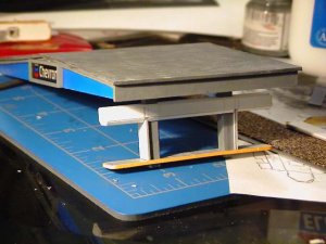

OK, a little bit more progress:
(A view from the back - restroom side - of the gas station)
The columns are finished - two sides are thick illus. board while the other two sides are thin posterboard. This leaves a hole large enough in the column to allow at least three bulb leads to be passed up through them. I've also finished the pump foundations... pretty much same construction as the food mart foundation.

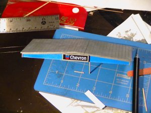

For some reason, no matter how many hours I spend working on a project, it only seems like I get about 10 minutes worth of work done. Well, after another night of working on it, here's what I've got to date:

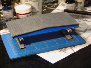

The canopy is now 100% complete. I decided for (bird-crud covered) aluminum panel roofing. :D I've started construction on the pumps structure. The illus. board "backbone" will be covered with posterboard, which in turn will be covered with the details.

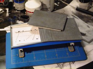

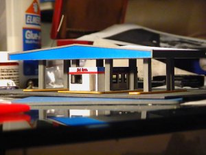

Here's another shot of the canopy with one of the roof panels removed for demonstration. Each piece has a "flap" that tucks under the roof peak (non-removable) and when fit snugly, is almost seamless. Accessing these light bulbs will be easy... removing the roof (and consequently having to put it back on 8 columns) is not so easy. :p

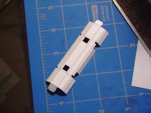

Here is a fold-up pattern I made to make the long part over the pumps. The end is shaped like the bottom half of a stop-sign. I left openings for the canopy columns to go through.

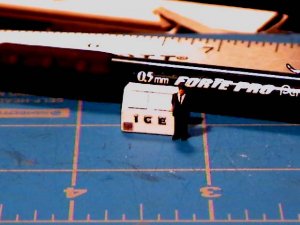

Here's the stereotypical "ICE" box you see in just about every gas station. For something so small, it was surprisingly easy to make. And it's the closest to prototype - I should know, I went to a Chevron today and took some more research photos. :)
Ummm I think there's some confusion about lighting? :oops: I meant that I use the desk lamp in place of flash. My digicam is a camcorder, and while it does have a built in lamp, it comes out somewhat yellow and isn't as good as the desk lamp.
As for the icebox, it was so quick in the making that I didn't stop to take pictures along the way. :( But it uses the same construction method as the long structure over the pumps. It's basically a small (5mm x 11mm) card stock base, with a posterboard "box" around it. The icebox doors are simply small pieces of posterboard and the "ICE" lettering is done with me new printer, as is the grime covered air vent (hard to tell) on the lower left. It's so tiny! I am really pleased with how it came out. :) I'm contemplating putting in something to represent hinges and doorlocks on it, but I need to finish the other details before I go crazy on one small item such as this. :)
