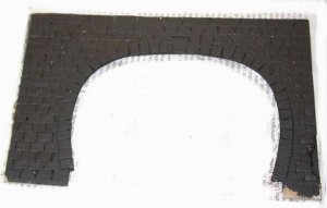

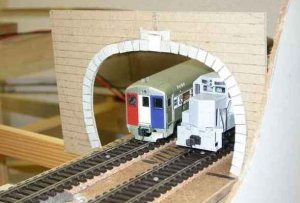

I wanted to build a tunnel portal made out of cut masonry stones.
Shaywen developped a fine technique for building such a portal out of pink foam. It's described in the Academy - see this link. But I don't like pink foam that much, so I tried Robin's favorite material: Cardboard! Then I applied some of Shaywen's coloring techniques to it.

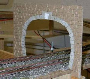

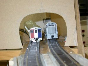

First I took a piece of stiff corrugated cardboard and cut out the opening for the trains.

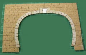

Then I added the tapered stones (called "voussairs") which form the contour of the opening. The shape of the center keystone with its cover stone is copied from a photograph of a PRR tunnel mouth.
These 'stones' were cut individually out of stiff cardboard (shoe box). After glueing them around the rim I drew the lines for the masonry stone layers...

Masonry structure

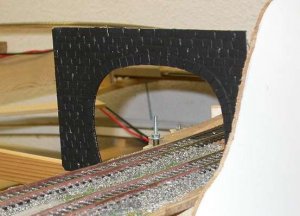

Next I structured the surface of the cardboard face.
At first I scribed the gaps between the stone layers with an awl. Then I added the vertical gaps between the individual stones with a screwdriver.
Because I used corrugated cardboard, the lines didn't turn out perfectly straight and even - but this is exactly what I tried to achieve. After all, granite masonry stones aren't all alike - the wall face shouldn't present the uniformity of a brick wall.
The next step was to paint the whole thing black, working the paint into every crack. I used acrylic paint for rustic arts, full strength out of the tube. I you don't thin the paint you shouldn't have problems with warping.

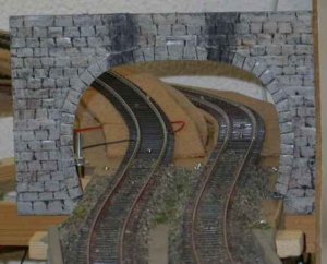

Painting the portal

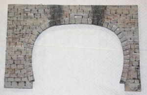

With several hues of the same acrylic paint I colored the stones. The colors were dry-brushed onto the black surface, giving the desired effect of deep cracks between the masonry stones.
Colors used:
Medium gray and a light brown as a base color, mixing them by dipping the brush alternatively into splotches of the two colors on my palette.
Oxide red applied sparingly to add a little bit of a rusty hue of brake dust clinging to the stones
Black, mainly for the soot marks above the tracks
White, also sparingly used, to higlight the upper edges of the stones.
Next will be building a short piece of tunnel lining...
