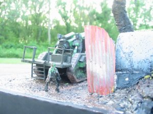

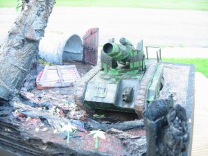

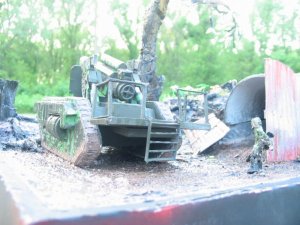

For a less dangerous form of corrugation, I submit my pictures of standard painted cardstock. Corrugated with a crimper, spray primer, painted with a rust base and drybrushed with a steel paint. Highlighted with silver.
