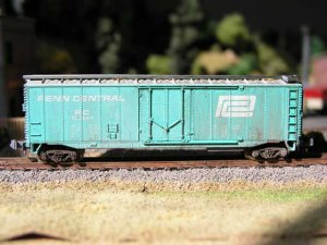

Ok...employing the Deano-method of weathering, this an older Bachmann boxcar, weathered by grey primer (spray can), alchohol to clean the sides, wash with water/india ink, then final wash with water/india ink/rusty paint color.
I was shooting for a lightly weathered look, moderate use, normal wear and tear.
Secondly, when were roof walks removed from boxcars? I'm modeling more current era but wondering if the roof walks were removed from the older boxcars to comply with the regulation(?) change.
Where can I improve - and be honest.

Looks good to me, although a bit heavier than everyday use might incur. However, if you're modelling the current era, I suppose a PC car in everyday use would be rather heavily weathered. :D To be completely fair, though, the shortcomings of my computer monitor have been mentioned several times, so perhaps I'm not qualified to even comment: I know what colour the car should be, but I'm seeing grey. Grey!!? Time to go shopping.:rolleyes:
The ICC permitted the removal of roofwalks beginning in 1966, although I'm not sure when it became mandatory.

doctorwayne - may I respectfully suggest you check your settings sir...that Penn Central is in fact greenish. (I was running out of "practise" cars and that boxcar was next on the list. But it is the Bachmann version of PC green which may not be prototypical.) But you're right that if this was a PC car still in use (are there any???) it would be in far worse shape than what I weathered. What I'm trying to get is a realistic weathering for an Nscale car. That seems to be the biggest problem...getting the weathering to look realistic for Nscale...not too heavy or overdone. But I'm finding that I really need to get an airbrush for any hope of putting on a fine enough mist of paint. Everything I do by hand seems too heavy. I plan on weathering more up-to-date boxcars using this technique and really want to get it right before moving on...but am open to other weathering techniques. I've also visited the weathering websites - but found they offered little in advice or good "how-to" instructions. Mostly they showcased really great looking work. Thanks for everyone's reply so far.
Hey, Herc Driver, I know that the boxcar is Jade Green, it's just this darn old steam-powered monitor that makes it look grey. Every once in a while, the red component will kick in, but it's usually absent. If you like the general colour of the weathering, try using the same colours, but with a greater percentage of thinner added. That should make the colours less opaque.

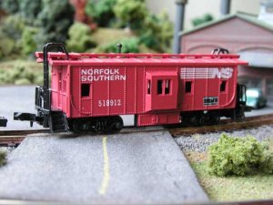

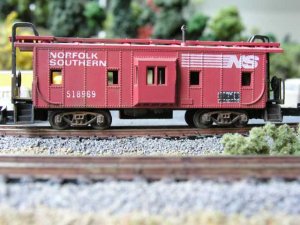

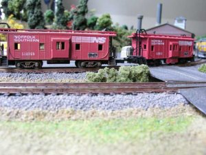

Newest attempt - this time chalks
Here's a side by side comparison of using chalks, again for your critiques.
Both NS caboose are made by Con-cor and were bought at the same time...one weathered with chalks using many of the suggestions you all have been kind enough to offer and the other is a like Con-cor car without any weathering for comparison. Overall, for Nscale I seem to get better color control using chalks than paints. (Camera close-ups show more chalk dust than your eye can see when looking at the cars on the layout and both cars photograph lighter in color than they appear on the layout.)
Comments? Suggestions? Areas to improve?

Thanks Josh, I needed a project that had a reference where I could see what progress I was making towards a more prototypical look. I found several examples online of this caboose and tried to mimic the look with chalks instead of paint. Again, these photographs are lighter than the actual car under normal lighting. I'd actually use these caboose except they run horribly. They both need new/better knuckle couplers - the ones installed now worked badly, and the trucks are too tight and won't turn well so they frequently derail. I hope to change both the trucks and the couplers then run them in a NS consist. Yep, the caboose is alive and well in this pike.

Herc, I THINK YOU DONE QUITE WELL!:thumb: i was never that good at chalks:( , but i think YOU have done REAL GOOD with them:thumb: . the caboose DOES NOT look over weathered:thumb: . i REALLY like the steps and trucks!:thumb: :D i say keep going with the chalks;) :D . cant wait to see MORE of your work with chalks:thumb: . THANKS!:D -Deano
Herc, may I make a suggestion on the first car? The inside of the climbing ladder looks too clean. I like the way you did the rundown weathering. Very dirty job. Keep em coming!
Chalks=good. Paint= so far, bad for me.
Good catch Sam...I'm reworking that ladder right now.
Unfortunately from the picture I took, I didn't show the sun bleaching of the entire roof. Using white, yellow, and orange on the roof, the red colored car looks bleached but not overly sun bleached. The entire car got a dusting of two shades of brown and gray. Some black was used to highlight as was some shades of lighter red steaked down the sides. Rust was used on the trucks.

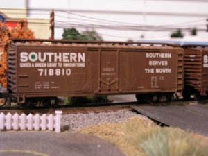

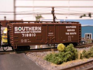

Two more for comparison
Just got these two finished tonight...er...this morning. Two matching (Atlas) Southern 40' boxcars - the one on the left is weathered, the other isn't. I was surprised by the color change...using white, and mostly yellow on this burgandy/brown car really worked the trick. The roof lightened well using light tans and yellows. Overall, it looked like the weathered car is about three shades lighter. I'll try tomorrow to take better pictures of the top and all sides for critique. I also worked on a jet black NW boxcar too...with both these projects it seemed like I'd try several colors until hitting that perfect (in my estimation) color that really worked the best, then the car would jump to life and look weathered and used. Started work on a Bachmann GP60 as well...found some great shots of a NS model really used hard that I'm trying to capture. After hours of searching for prototypical examples, it seems there's not a huge variation between almost any car of like color. No matter what the color, they all rust, all get sun bleached, all have their lettering run down the sides, and all have dirty front/rear sections near the couplers.
Now, after they're done...do they get dull coat sprayed on to "lock" in the chalks?
