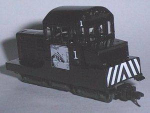

Beautiful, Matey! Guy at my LHS dug around in the decal bin and pulled out somethin' for some knida rollin' stock that had white zebra stripes. I used 'em and I think they were a lot easier and prob neater than painting. I can find out what the number is...
Chris, I originally wanted yellow, but he didn't see it in the drawer. Perhaps you can locate something that had yellow stripes, then see if they make decals for it. These are from Microscale 87-606 (Montana Rail Link Cabooses & Freight Cars #2). There are two sets of stripes in the set, each about 1" x 1 1/2" which would allow me to make two more critters :D

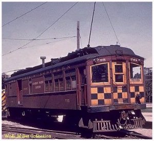

Hi Jon I have tried the decals ,, they cover to much coach detail and the digital tells no lies:(
So here is a picture of the checker board type...decals should be O K here if I get my magnify glass:D .
