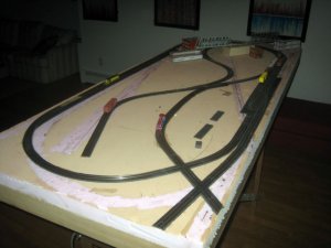

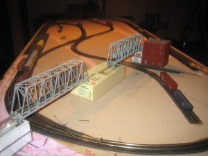

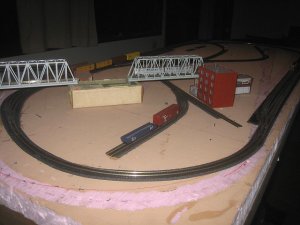

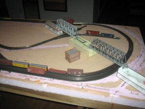

Finally got around to finishing the trackwork- now comes the wiring part! After months of virtual standstill, an upcoming house sale has finally opened up some time to get my trains running- I figure it would be a nice addition for some open house walk throughs.
As you can see, I took the Carolina Central theme and modified it slightly. I'm modelling a more urban area, along the lines of the south side of Chicago. I added a couple more twists to the tracks, where I plan to have the trains snake their way through some "concrete canyons". I'm also gong to put in a "high line" of sorts, although I haven't decided if it's gong to be home to the "El" I have up there now, or if I'm going to make it a freight line. Although I'm leaning to a double tracked main line, modelling one line as abandoned.
You can see where the old layout was- I laid most of that track before I made a few mistakes- namely, when I was cutting insulating gaps past the frogs, I cut them too close to the frogs (actually cut the turnout- and effectively destroying the turnouts- that was a costly lesson. Oh well- I switched from Blue Moon to Budweiser for a few weeks and all was well). This time I'm cutting the gaps an inch or so past the rail joiner. I also tried to do too much for my first layout, and I fell for the trap. This time it's KISS. Well, mostly anyway. I'm sure the diamonds might pose some challenges. We'll see.
Oh, I also learned that it's not neccesary to actually glue EVERY piece of track down, especially the turnouts. Glued points are fun to work free.
Actually, they're not.
All the track is Peco Code 55, except for the 90º crossing (Atlas Code 80) and one of the turnouts on the siding track in the back, which was an old Peco Code 80 InsulFrog from a previous layout.

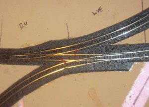

Anyway, I have a quick question concerning the turnouts. I'm using Peco ElectroFrog turnouts, so I know I have to cut insulating gaps past the frogs on the turnouts, but I'm not sure where to cut gaps in this section of track. Can anyone give me a hand here?
I'm only wiring this entire layout as one block- DCC is right around the corner, and I'm not a fan of complicated wiring.

Gaps should be in the 4 inner rails between the 2 turnuouts as shown by the red lines in the picture.
The gaps don't have to be in the exact position shown, but they must be between the frogs and the points (2 rails connecting the turnouts), and between the frogs and any feeder connection (other 2 frog rails).
yours in wiring

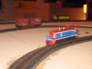

Anyway, I'm hoping to have some trains running shortly- I really like my MP15 switcher (in the BRC colors, one of my favorite railroads). Amazingly sweet machine!View attachment 36638

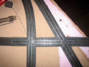

anyway, here's another gap question. Do I need to cut gaps anywhere along these diamonds? View attachment 36648
They're the Atlas kind, so I don't think they're power routing. At least, they didn't come with a bunch of wires dangling underneath like the Peco diamond did...

gringo: I'm a bit late commenting here, but here goes.
The Atlas diamonds shouldn't need any extra wiring.
The crossover needs only the two gaps between the switches. The gaps in the rails leading to the spurs aren't really necessary -- they can be shifted down the rail to the end of the siding. Unless you want to run something on the siding while the switch is set against it, say, keeping a sound unit burbling. If it were pure DC wiring, I would suggest going for dead sidings, but DCC guys like to have everything live.
And I agree with Katy -- there seems to be a dogleg at the top of that crossing.

I also fixed the dogleg at the top of the 90º diamond- I had previously modified the ties underneath bu cutting out the spacers on the inside curve, much like you would find in flex track. When I had originally glued the track in place, it was too straight; yesterday I gentley pulled up the track, spread some fresh glue and pinned it in place with a gentle bend. Today the track looks much better- I'll post a pic as soon as I take one!
