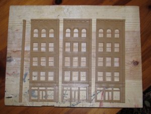

I am getting ready to conjoin two City Classics Grant street Iron fronts to make a building with twice the footprint, Joining two front walls, two back walls, and two pairs of side walls.
These city clasic kits are nice. They are similar to DPM kits, except the level of detail is considerably better. Except for the modular stuff DPM's tallest building is the MT arms hotel, which is four stories, but the stories on the these City Classics five story buildings are considerably taller than the MT arms hotel. It has been fun playing with this stuff . While I have been a logging modeler for close to 40 years I uased to admire the traction modeler's work in Cinncinnati OH, where I lived in the late 1960's. the new larger Harlow Tn. ( now the third argest city in Eastern Tn., behind Knoxville, and Chatanooga ,) gives me a chance to scratch an old itch itch , and I'm having a lot of fun with it.

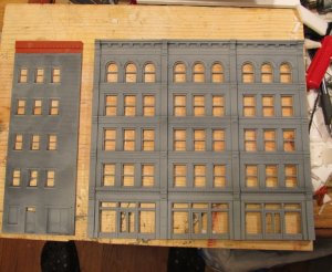

I got the four walls of the doubled City Classics Grant Street Iron front assembled, and am attempting to spray paint them flat black on the interior, and flat black on the outside ( to kill any transpearancy) followed by grey as a base for drybrushing the biricks. still not sure of the color I will use on the fancy front of the building I like green, but many of my buildings have green trim, and I may go with grey, I'll see how the initioal coat of gray looks. spray painting today is very challenging, as we have a lot of strong wind gusts, so I have to wait till the wind hits a lull, or I can spray six inches from the model's walls, and get no paint on them.

Having lots of fun, work and the pursuit of firewood has slaowed me down, but I got the Ciry Classics Grant street Iornfront shell put together . using the parts from two kits to make a building with four times the footprint. This building dominates the scene currently , I plan to build a tower on the court house, and put some truely massive trees in the courthouse lawn, and it shouldn't be quite as overwelming. I need to add some floors, at least near the front of the building, and it needs a roof , with chinineys, a lottle structure where the stairs come up. One crazy part of my brain thinks it would be cool to put a roof top garden up there, the view would be awesome, as it is in the middle of the bend of the river. I have two sets of Walther's vintage fire escapes on back order, and I have one in hand. am going to pit fire escapes on the back side of this building, and the flat behind it, which will make the scene in the alley at the foot of main street more interesting.

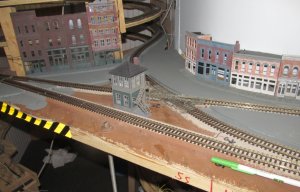

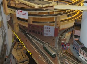

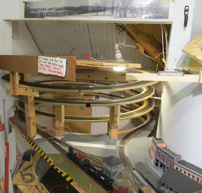

at the far left of the front of Harlow, I have the helix. In my earlier layout, the whole center aisle was taken up with steep mountain grades and scenery. it looked fine (see the logging minning and industrial railroads section, logging in east TN in 1928 on the DG, CC, & W RR ) . The helix , which you can see the bottom of in this photo, is functional; but as ugly as homemade sin; and it is the feature that gets the vertical climb needed to get to the upper deck, freeing um the middle deck for the large city sceane.
I want to be able to see trains on the helix, for operational reasons; so I don't want to make a compleate view block, but neither do I want my city scenery to end in a haphazard pile of plywood and two by twos, so I'm going to try to split the difference. in the above photo, the two and three story flats did not do the job, so I tried some other flats I had around.

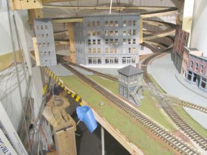

Im this photo I have the beginnings of streets and side walks in place. these flats are made from some DPM modular sections and some wall section scraps from the parts hoard. they fit better, but it is not Ideal. As the anchor for the next try is three City Classics East Ohio Street building kits. I used one of these up near the courthouse, and liked it.
An interesting feature of this kit is that when they designed it they planned for kitbashing multiple sections together. they left the left baulistrade (Not sure that's the right word) off the main front wall casting, so that two front wall sections can be added together without doubling up the baulistrade, or laboriously removing one of them with a razor saw. by casting this part seperately, I can patch three wall sections together, leaving two baulistrades out, putting one in place on the left side. (Is it scratchbuilding if the manufaturor plans for you to do it). Like DPM kits the molds are not square edged, to allow better relase of the finished walls, so I squared up the wall sections by placing a piece of sandpaper on a sheet of plywood and rubbing the edge of the wall on the sandpaper while holding it at a right angler to the sandpaper.
This flat will become the anchor to the helix disguising fronts along what will become Mississippi Avenue. the road to the right will be Main Street, a some of the flats currently on Mississippi Avenue, will get moved over to the far side of Main Street . The track entering the helix is my mainline heading South East. the tracks to either side of the tower , which is the Southern Railway's South tower, are Southern Mainlines closing the return loop, and the track down the helix to the Southern Staging.

I have the three City Classics Ohio St fronts glued together. the unique design of this kit lets you gang front sections without surgery, or having the center butresses doubled up, very nice. The space in front of the helix was a little longer than the three fronts so I'm adding one back wall section. to raise the height, I added a section of brick from a DPM modular wall sections loading dock base, and then added a fancy cornice section on top. these will be painted flat black, and get the gray primer on top of it. later I will dry brush the brick surfaces of both buildings with brick red acrylics, trying to leave the mortar cracks gray.
I will put glazing behind these fronts, but nothing else. the helix will be partially visible behind the flats. I want operators to be able to track a train's progress through the helix. these front's will just soften the abrupt tnd od scenery at the helix.

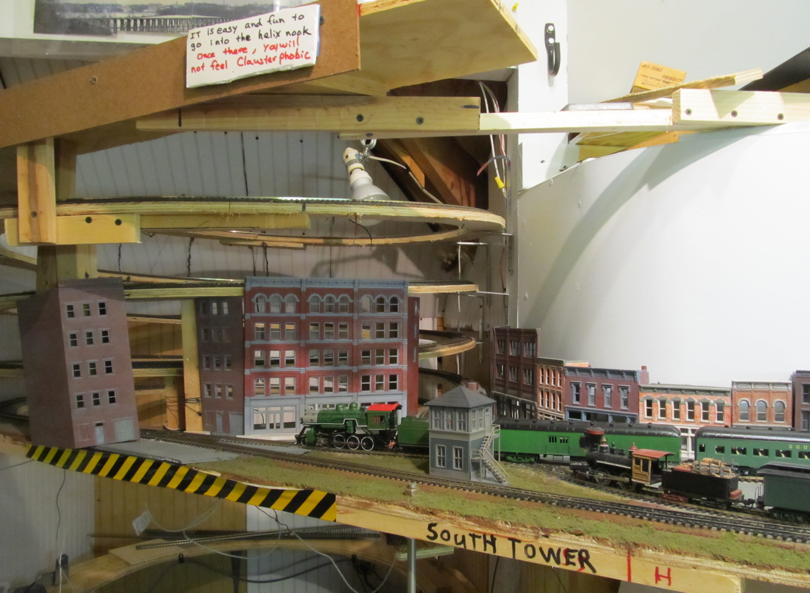

I have ddone some modification to the E Ohio Street fronts, in order to fit them on Mississippi Avenue in front of the helix . I'll add more wall sections, and dry brush in the brick color. My goal here is not to completely block the view of the Helix; I still want to be able to see trains go up and down, I just don't want the helix to be too distracting from the city scenery in front of it.

I posted a photo of the helix without the E Ohio Street buildings, have been working on painting the brinks, a multiple step process. some of the pannels are not done, so I haven't taken the time to get them straight, as they will be going back to the work bench.

An excelent choice to cover over the large open area of the spiraling tracks.. Abig well done to you Nemson. frank
