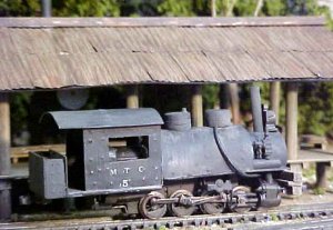

I've gotten a little more done on this one since the last post...
I know it's kinda 'hinkey' lookin', but here is Matthysen Timber Co # 5 as of today...
