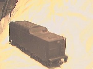

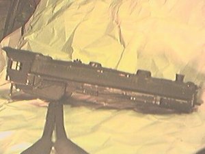

My apologies for the quality - cheep camera. :oops:
Best detail I could get.
Google/AlltheWeb search didn't have mention of an Arbour Mikado, but 0-4-0, 4-6-0, 2-8-4 & the Allegheny, so a Mike seems plausible.
Hope this helps.
regards,

Curmudgeon, based on your photo, what you have is a Mantua cast boiler from their 4-6-2 Pacific, not their Mikado. Likewise, the tender is the standard Mantua longhaul, 6-axle, tender.
If the mechanism is indeed that for a Mikado and everything fits together perfectly with the boiler, then it is likely to be an example of their "light" Mikado, produced for just a few years around the late 1990's. This loco used their Pacific boiler in conjunction with their 2-8-2 Mikado mechanism.

Hi cnj -
You may well be right - examination of the Pacific boiler pix shows a very close similarity.
Enough so that there could have been mods to it to produce what I have.
Not to belabor the point, but has anyone ever seen a Mantua w/no name on it, tho'?
Perhaps in the course of modification, adding details and whatnot, the Mantua name got ground off? Such is the case with my Shifter. At any rate, the Mantua name was cast on the underside of the boiler just behind the smokebox. Not sure if that's the standard spot for all their engines, however. Check with the guys at the Yardbird Group.
This one also has no cast-in throttle assembly.
I'll agree any of them could be filed or ground off, but that visibly changes the surface - and I don't accept that someone could do so w/o distorting any boiler bands or the sandbox sidecover, & then reproduce the original surface finish to the point it wasn't detectable under 16x.
