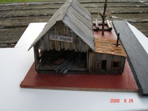

J.R. Booth needs a new sawmill, the old is run down. Under logging and mining
you can see the new sawmill McCabe.
For some reason logging and mining etc; is down.
Bill

Excellent work Bill. Thank you for sharing it.
Extremely well detailed and weatherd.

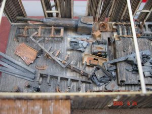

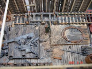

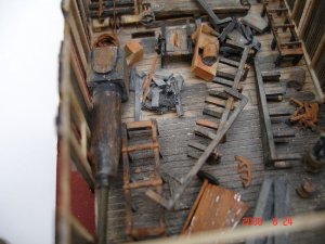

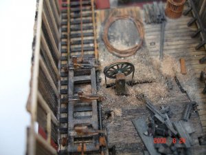

It is not for a diorama. I build my models on hard cardboard so I can detail them at the work table, then I glue them to the module. The light gray is Age-It Easy by Micro-Mark. The brown detail over the light gray is dark brown
leather dve mixed with alcohol. The very dark gray is my on mix of India Ink and alcohol. For the rust look, I like to use Model Tech Studios Rusting Solution.
After the inside was finished,I scraped some light yellow chalk over all the junk, then used a soft brush to spread around.

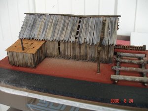

I sometime use washes of paint. The McCabe sawmill project, all the walls were sprayed with a light gray first, then spray or brush on the main color .
After, take fine sandpaper and sand off some of the paint.I have no tried and true system on weathering. What ever my brain tells me how that would look, is the way I try to make it look. I do read books on weathering to get ideas.
I take pictures of tin roofs, old buildings, logs, trees, landscapes, etc.
