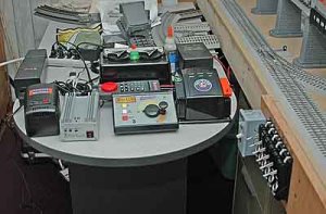

Track #1 is wired for TMCC and Conventional using the TMCC system, TPC 400 and a 180 Watt Power Brick. Track #2 is powered by the Lionel CW-80. Track #1 and Track #2 do connect by using four turnouts. However the tracks are insulated between the turnouts so that two trains can be run by two different power systems.

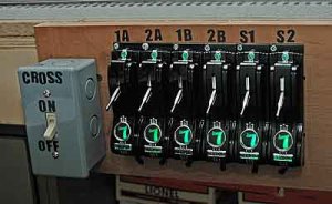

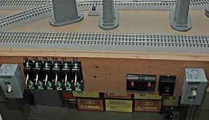

I had to wire all of the turnouts to a secondary power system. TMCC doesn’t recommend using the track to power the turnouts. For the power I use the left side post D & U of the SW 135 postwar transformer. I have reserved the right side posts A & U for the future trolley line. The advantage of using a secondary power system is that the indicator lights are always on.
I added two sidings to track #2 and I insulated these so I could park full trains. In addition I incorporated a uncouple track and a dual purpose uncouple / dump track in the sidings. So I have two choice to park trains on isolated sections of Track #2. The first is ½ of the loop, which is also isolated, or the sidings.
Track #3 will have a dual power system. The primary power will come from the MTH Z 1000 to run the Aerotrain. However I will also wire it for TMCC by using another 180 Watt power brick and a TMC Lock on. This will be a cheaper way to run both TMCC and conventional trains on the track. (To do this with just the Power Brick I would need to buy a TPC 300 or 400, so since I have the Z 1000 I will just dual wire the track)
All Power wiring is gauge 14 with two drop downs for each track. The isolated wiring is also gauge 14 from the turnouts to the on / off switches. I used common wall light switched to control the isolated track sections. I used gauge 18 for all turnout power lines to the secondary power transformer.
The only thing that was a problem with wiring the systems was that I underestimated the amount of wire that I needed. That resulted in a few extra steps to the hardware store. The mix of transformers was not planned; I just decided to use what I had so I have more than enough power even though it does take up some space.

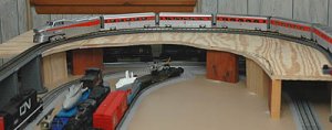

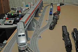

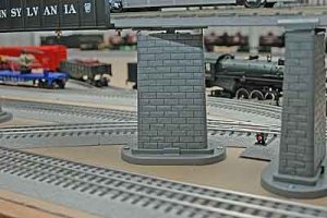

Here are some photographs. They show the double siding, the power center, switching center, main corss over, and just one of the big CN on the bridge.
I can't count the hours I have into this layout, it does take more time than I thought. I don't expect to have the landscaping done this year. :(

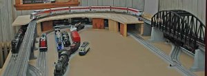

It has taken just a little over a month but the track is now 90% installed. I only have the trolly line to figure out. I now have three tracks operational after completing the elevated tier last night. I don't even want to think about all the landscaping that comes next.
Sorry about the quality of the photographs I will work on that later.

Looks good!! I have a question, What is the height from the layout table to the top of your track on your second level? I have a 9" clearance that I can build upon, and still fold up my layout. Keep posting, with my small space, I am getting ideas from you..
From the bottom to the top of the second tier track is 6 & 1/2 inches. So if you have that much rrom you should be able to fold it up minus any bridges or anything else above the top of the track.
I hope this helps.

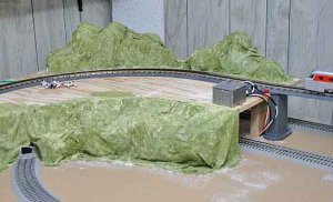

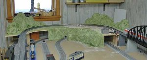

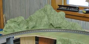

I constructed the first mountains today. After viewing and reading about many different ways to do it I went the old route, paper and plaster cloth. This has to be the fastest and easiest way to construct mountains. I had three nice ones up in less than 30 minutes with no mess.
I just crumpled the paper and taped it all together and placed them were I wanted the mountains. It was a simple process to dip the plaster cloth and cover the paper. I was surprised except for a little dust cutting the plaster cloth I really didn’t make a mess.
Tomorrow after it has set for a day I will give them a base coat of paint. I hope to have a good start on the upper tier by tomorrow so I can post some interesting photographs.
[FONT=&quot]I will admit it was more fun than I thought it would be.[/FONT]

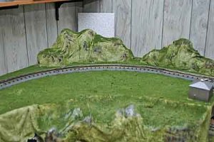

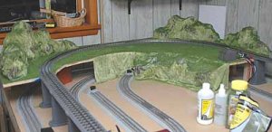

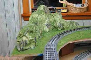

These are my first mountains and my first ever at landscaping. I am happy with the results and I have applied a base coat of coloring. later this week I will start to mix some more color into the mountains. After that I hope to start with the grass, shrubs and trees effects.

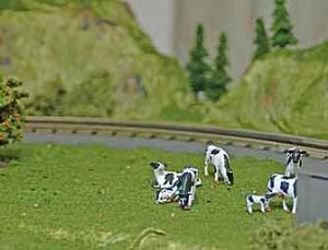

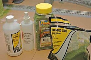

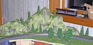

Ok I have move forward and now have some grass growing on the farmland. As you can see I just got it done and if you see some white stuff that is just glue that has night dried yet.
I'm not an expert in the art kind of work. I do my best and to tell the truth it isn't so hard. I used some black, grey and brown to break up the mountians, I think it worked out well.
In any event it is all of my work and the only thing I can do is plant crops so this landscape work is new to me.
