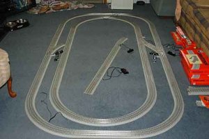

I told you I would get around to some photographs. This is a look at the raw layout placed on the floor so that I could get a real life overview. I am still waiting for 2 right hand switches and the track stop for the siding.
This will be the track for the plan for the bottom that will enable me to run two different trains or park one and be able to use part of the inner track and the siding. I have added a decoupler and an activator track in the siding for future use.

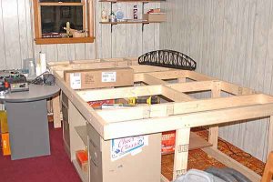

Ok I spent the last few days getting the room ready and getting some wood together. I think it is funny that after you get the frame work done for a basic 5x9 table it looks small.
I still have some supports to add but the layout has been started and I incorporated an old metal desk for both support and storage.
This is a flat farm land layout and will have a second mountain level added. I know its not much to look at but it is a start, one step up from a floor layout.

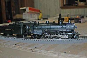

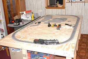

I ran trains tonight. :) The first stage of the rough bench work is done. I made some test runs just to see how the fastrack sounded on bare plywood. To be honest I have no clue where all this noise stuff comes from. In fact I would call it pleasantly quiet, I had no problems with it drowning out the railsounds.
In any event I now have to get use to run on the edge with a nice drop to the floor.

Looking good. :thumb: You're getting me fired up to start my layout, soon to be photo'ed. Noise?? All have it,.. I wish I could get my house to rumble. :D

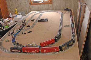

Today was the official start of laying the track. I spent the past few days running the train to make sure the ceiling tile was going to be good for the job. I am happy to report it was and that I gave it two coats of paint to seal it.
The process is going a little slower than I thought but then again I’m running the wire under the table. It is a good idea to label all the wire and to make sure you write down the color order for the switches.
The block wiring is going pretty well but is tedious. However it is worth the trouble and will permit the operation of two trains on the same main line while in conventional mode. In addition I have block wired the only siding that is in the track plan.
I am still waiting for the two right hand turnouts I ordered from my LHS. In fact I’m still waiting for my TMCC set up, bridges and lighted bumpers.

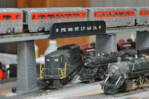

[FONT=&quot]I have started the second tier, which is basically a third mainline on piers and a small tunnel. However since I now have a larger diesel I found that my original track plan for this tier would not work.
This was something I did not think about when make the original design. While I accepted the fact that my locomotives would be limited by the size of the track curves I forgot that in addition they would be limited by side clearances such as piers and the like.
In any event I am now re working the track plans and will review other areas so that I have the clearance needed to run the longer trains.

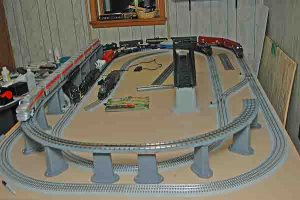

Construction has both been slow and over budget. I did start the elevated section of the layout this weekend. The only bad part is that I am still waiting for two right turnouts and two bridge sections. I have made a few changes including adding a TPC 400 and upgrading the wiring to 14 gauge. In addition I am waiting for my 180-watt power brick and TMCC controls. The pleasure of dealing with a smaller LHS.
I did find one thing out Fastrack is far better to work with than the Real Trax. Real Trax is much harder to take apart and at times will damage the lightweight copper connections. To be blunt RT is a pain in the backside compared to FT. If I had it to do over again I would not of used the Real Trax. The Fastract connections are far superior.
[FONT=&quot]Well this is about as far as I can get until the rest of the supplies comes in so I can start making the tunnel and mountain sections. I just hope the Aerotrain doesn’t try to make its daily passenger run on the track to nowhere.
Overbudget items - TPC 400, addition 36 turnout for a second siding.
