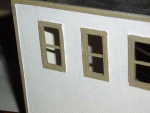

For stucco, I have glued 220 grit sandpaper to the wall of the building, giving it textrure. After a few coats of an off-white paint, it looks great. for windows - slice the cerealboard into about 3" scale strips with a hobby kinfe and a straight edge. glue the strips around the perimiter of the window to form a moulding. Glue more strips around the inisde perimiter to form the window sill. For the sash, I glued one piece of stripwood horizonatally down the center of the window. Hmm. I should post a photo.
