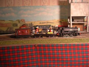

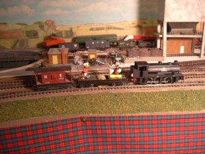

Mauiman asked about my track cleaning car.
Certain figures have been added to make it less dull.
