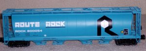

i guess i have never known anything but grain or beans to be carried in hoppers,
