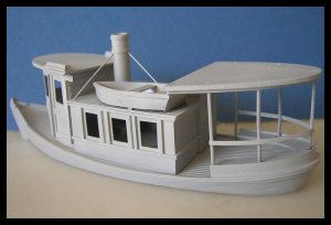

This is my first submission to the Hobby Forum. I would like to share a recent project in HO scale for a Maine style river steam boat. I started with plans from a large scale magazine and reduced them dowm using Photoshop Elements and printing them out on my home printer. The hull was made as a water line model. I began with a block of balsa and attached a paper pattern to the top of the block showing the hull outline from the top down and also attached a paper pattern to one side showing a hull profile. I used a scroll saw with a tilting table to first cut the top pattern and then the side profile. After "LOTS" of sanding and balsa wood sealer, wet and dry paper and many coats of paint I had a hull. The hull was used for a pattern to cut the deck, oversized and sanded to a final size. The pilot house was layed out flat on thin styrene and bent around a jig to get the correct shape. Passenger area was plain straight forward flat construction. The stern area open deck does not show yet but will be covered with a wood deck, railings and seats for passenger comfort.
Thanks for looking and feel free to comment and suggest

That's a beautiful little ship.
It's coming along nicely, and a fine, clean build.:thumb::thumb::thumb:
Are the plans available to buy, or was this a magazine article?
:wave:
This is coming along quite nicely! What are your plans for the ship when completed?

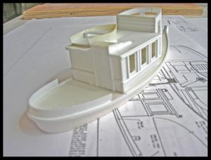

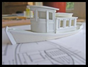

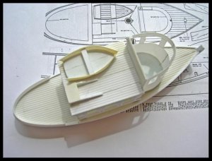

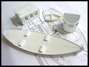

Here are two more pictures showing the next stages of construction. I'm also using this same technique to build two lobster boats to add to a dock I'm scratch building on a new module for my home layout.

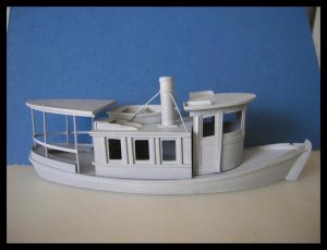

Here she sits at Fish Camp waiting for deck details. I used a light wash to bring out surface details. In search of small beads to use as running lights, cleats and rope.

That' a little beauty, Roughneck.
If you have the patience - and the eyesight - you can cut out segments of plastic leds for the running lights.
