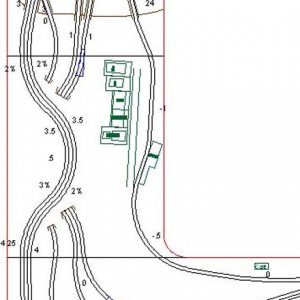

I must have posted this in another thread. Here it is again. This is what I have planned to fill the gap.
3' extension takes shape
Well, progress has slowed a bit but the three foot extension is starting to take shape and look like something. One great thing about this extension is that it has allowed me to reduce all but one of my 4% grades down to 2%. It was a little complicated to figure out as I already had most of them laid and covered with cork but with some minor demolition in some areas and some creativity in others, I managed, and I think my trains will be much happier in the long run!
