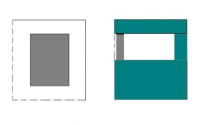

OK - here is the situation - in order to know what you can fit in the 10x9 space, we need to know how large your locomotives are - this determines the minimum radius you need in order to do loops and continuous running. Do you intend to run only small diesels, or do you want to be able to run a 2-10-2 with minimum overhang around curves?
OK, so in a 10x9 space:
If you cannot go outside that space, even for access (i.e. no standing in the other spaces due to storage, or other structures), you will be limited to a 5x6 table - assuming that you want a 2 foot wide aisle all around.
In this case, I would highly recommend that you look at www.gatewaynmra.org. They "specialize" in the "old standard" - the 4x8. They also have various layouts that are actually smaller than that. They are all HO. There's plenty of structures on each one (important, since you've said that's something you enjoy).
Alternately, you can build a 10x9 with a central "operating pit" of 5x6 that will give you more running room, but narrower shelves. However, this overall is more real estate (30 sq ft for the 5x6 table, versus 60 sq ft for the shelves). The big drawback here is the need for a duckunder or a swing/lift gate of some kind.
If 10x9 is as big as the structure can be (with space outside to stand/operate from), then your options are somewhat greater, as you can increase the depth of the shelves or table where you can make them accessible from both sides.
I have tried to draw what I have written above...
In the left part of the picture, the shaded area is either 1) the table, or 2) the operating pit.
In the right part, I assume that the left and bottom are open, therefore the benchwork can be deeper and operated (or at least accessed) from both sides. Continuous running could use a duckunder or gate (grey area) or be restricted to the larger part of the benchwork (which would be approx 4x9).
Hope that helps.
Andrew

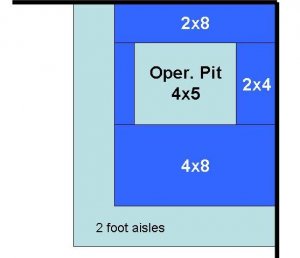

I built one by putting hinges at one end, and wingnuts on the other end. The section drops down, and the electric lead to both the section and the approaches on each leg were run through the connection of the wingnuts, bolts, and metal plates. I spiked the rail down after completing the drop down section...but be careful...I sent a mikado to the floor a year or two ago (it's been repaired).
Here's a picture...
The various parts of the layout are marked with size - dark blue squares. The outside of those totals 8x10 feet, with the 10 foot dimension on the right side. The light green areas are the space that is required to operate the layout - a minimum 2 foot aisle, plus the operators pit.
The basement walls are indicated by the heavy black lines.
Andrew

You were asking other questions while I was drawing!
There are several good threads on The Gauge about hinged sections - gates, lifts, etc. For a layout this size, I would recommend that you wire it so everything goes dead when it is open to avoid the dreaded plunge to the (concrete) floor. With a 3 year old running a train at full speed, it won't take long to reach the gate from anywhere on that layout...!
Keeping it aligned can be done two ways. One that I saw the other day at a friend's place was hinged, but that only loosely swung it into position - the hinge was purposely left loose so that it could be bolted/clamped tight at each end. It certainly wasn't a quick open/shut type.
MR had an article a while back about a really nice gate that not only cut power to approaching track, but also had an electromagnet to hold it shut so it could not be accidentally opened. I'll try to remeber to look that up, or you can search the index of magazines at www.trains.com
Andrew
