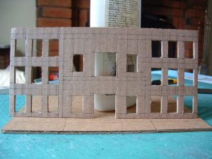

Another building to go on the corner Ntrak module I am making. A courthouse.
Usually I start with a corrugated cardboard frame and add cerealboard with windows and doors. This time I wanted deep windows so have cut them oversize in the corrugated cardboard. I will add trim strips to hide the corrugations. Next I plan to put the cerealboard walls onto the inside of the corrugated cardboard. I hope this will give the effect I am looking for.
No paper plans for this structure. The size is dependant on the space I have given it on the module. I then draw the walls to N gauge scale and cut it out.
This shows the first cuts.

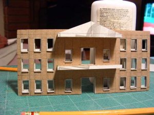

Got the trim strips added and the cerealboard background cut out. It is loosely behind and not in place yet but gives some idea of deep window wells.

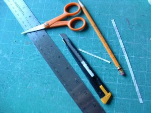

I'm sure you already answered this, but how do you cut all them little pieces? DASH

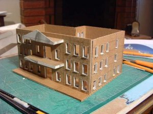

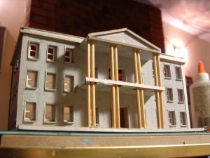

With remaining walls in place, the courthouse begins to take on a bit of character.
Shamus, you rebuild layouts as fast as I build buildings.
Robin, those double columns look very impressive. They give the building a very serious touch (as it should be with a courthouse). Great work!

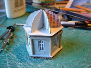

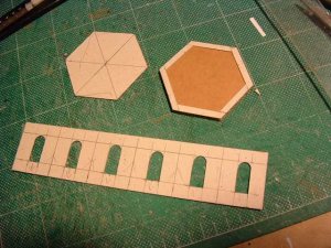

Today I started the dome. Here are some of the pieces that will make it up.
Size comparisons?
Hi there Robin, as I said before I'm also a big admirer of your work, it even inspired me to do this year's Christmas Crib out of Cereal box's, but the purpose of this post is to ask, if possible, to take a picture of this structure near a CD case so that I could be aware of the size of it, most of the time this pics don't really help in aknowledge the real size of this works of art. Oh and as said by others, even if you find it repetitive we really lyke to see it grow piece by piece.
