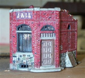

I've looked all over for an Old West type jail but didn't find much. I finally settled on a Rocky's Tavern by WS. I substituted bars in the window for the advertising decals. For my first white metal kit, I think it turned out ok. Most of the work was in the painting. I downloaded a pic of an interior jail shot from a movie set and installed it inside as an interior viewblock. I also added a couple of wanted posters but they're so small you can barely make them out. A little more chalk weathering and a shot of dullcoat and I'll be ready for my first "guests".

Doc, this is the same kit I'm working on I'm waiting for my paint to cure before moving on. What did you use to join the pieces? This is my first metal kit. It seems a little to small for HO scale don't you think?? Pat
Thanks for the kind words.
Pat,
I used a gel-form of super glue (CA) from my LHS. The hardest part of the whole thing was glueing the sides together. They didn't really fit too well. I had to do a lot of filing and clean up of the casting. The castings don't have any totally flat sides to I couldn't use my normal techniques to get the corners square while gluing. I had to eye-ball it. Guess my eyes aren't what they used to be. One hint, make sure to align the bottoms of all four walls. The top of the rear wall is lower than the sides. I matched the tops and had to break it apart and reglue.
