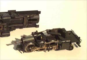

My Sunset Models 2-8-8-0 uses a spring loaded bearing plate. My PFM Sierra, 2-6-6-2 has a small wheel instead of a flat plate. It is also spring loaded. The supports for both of these are hinged in the frame, and the spring tension can be adjusted.

Thanks Pete, that is exactly the kind of information that I need. I hadn't thought of a wheel but I see now that that is the perfect way of puting weight down without creating too much friction between the boiler and the front engine.
Can you describe the mechanism on the Sierra a bit more?
How is the spring tension altered?
Is the wheel on the engine or on the boiler?
Is the bearing plate that it acts aginst flat or shaped?
What do you mean by "they are hinged in the frame"?

Here's a shot of the front engine frame, ans the bottom of the boiler of the sierra 2-6-6-2.
