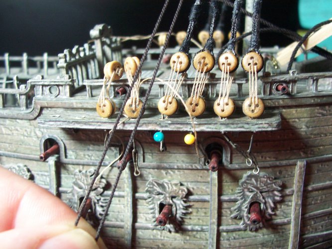

Belaying Pins Installation - Continued​
This is the pin rail at the foremast location. Those large "posts" are where the ropes go for the raising and lowering of the lower foreyard.

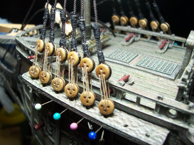

Here we have the lanyards for the lower foremast installed. The strops for the lower dead eyes are long enough to reach out from the bottom of the channels, which is handy! The chain plates are just loosely hanging at the moment.

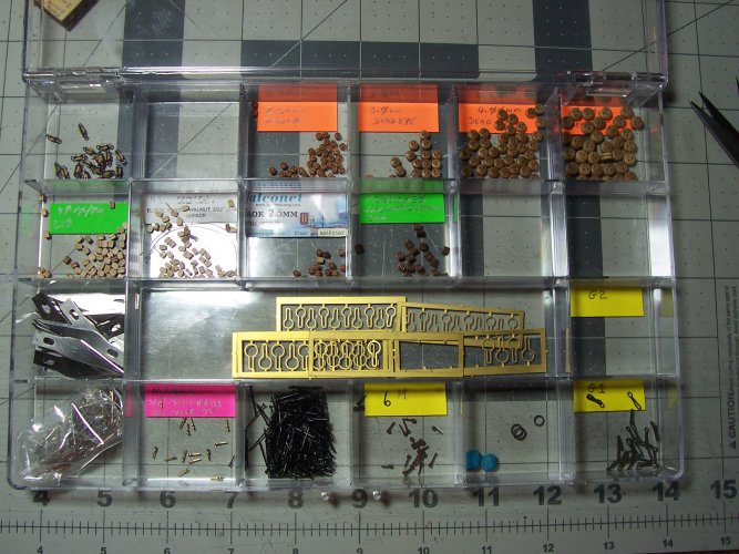

If you do decide to rig the Flying Dutchman, you will need a *load of fittings. You will also need to organize them all too.

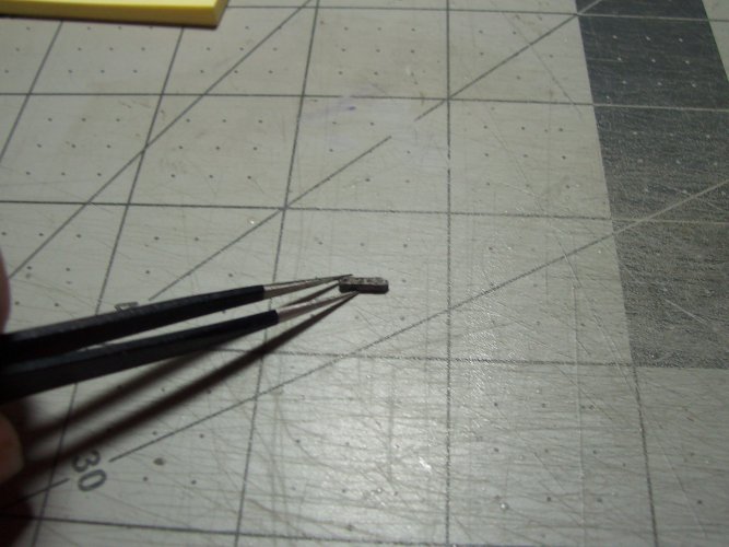

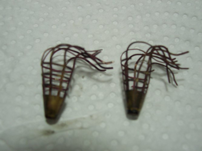

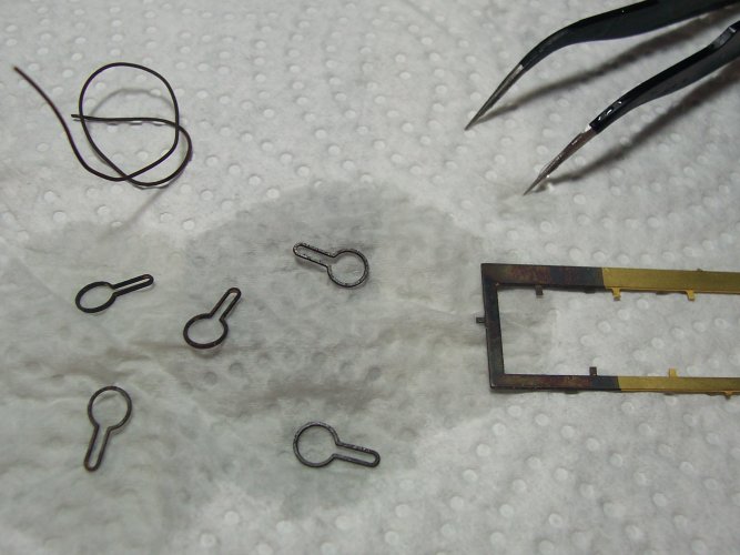

You can see here the brass sprue that I experimented on dipping into the black acid. Hey, that would be an awesome name for a rock group! "Black Acid :skull".

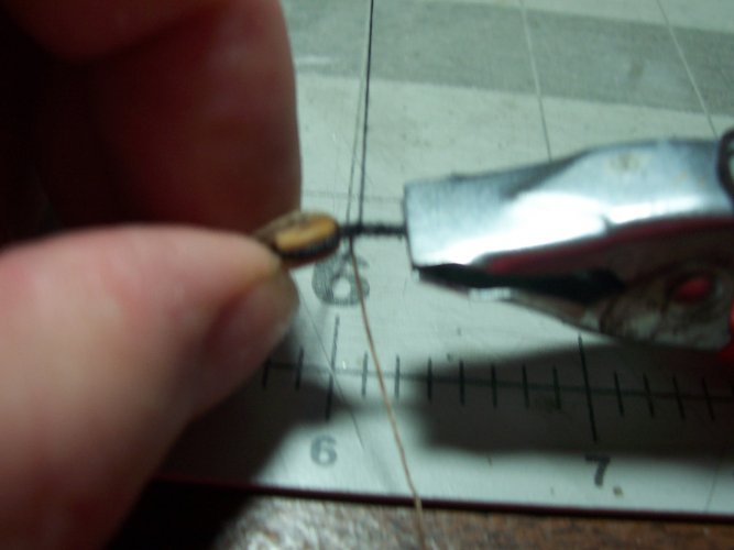

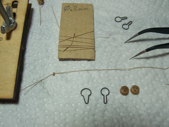

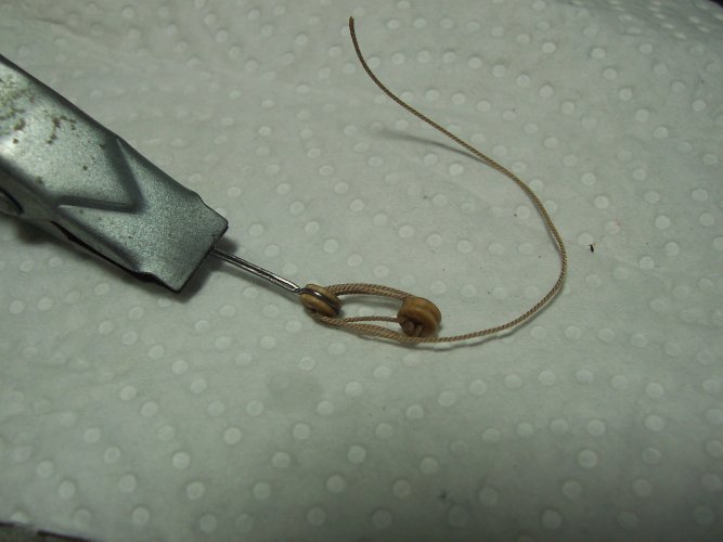

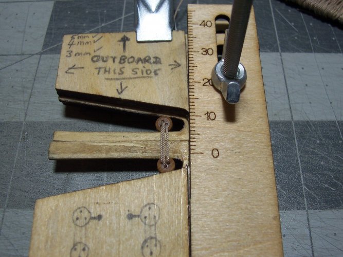

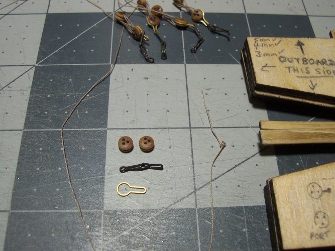

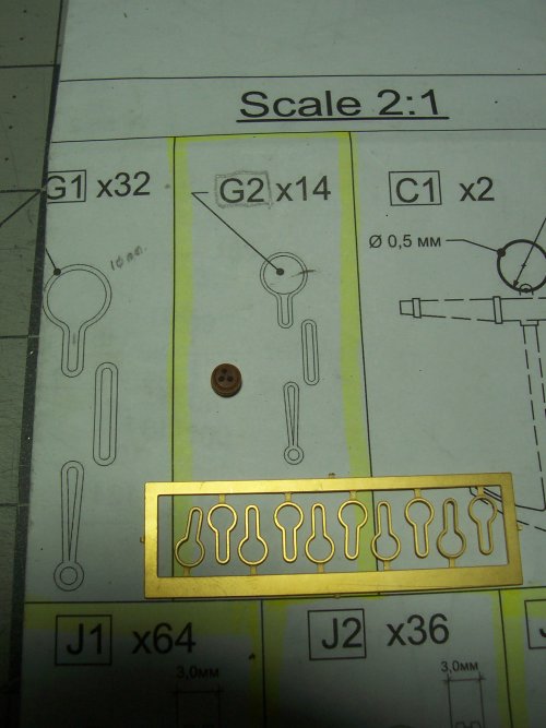

This is how you use those brass etched strops. They need to be integrated with the lanyards when putting them together using the jig. I have some white glue here to keep them together.

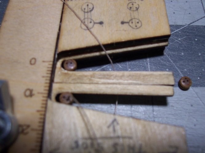

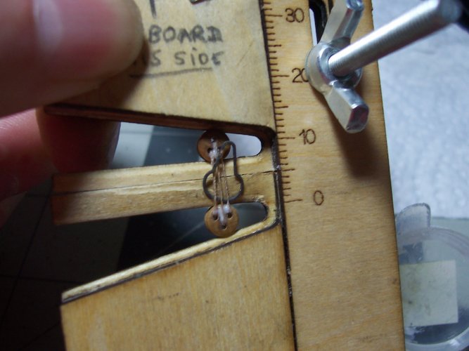

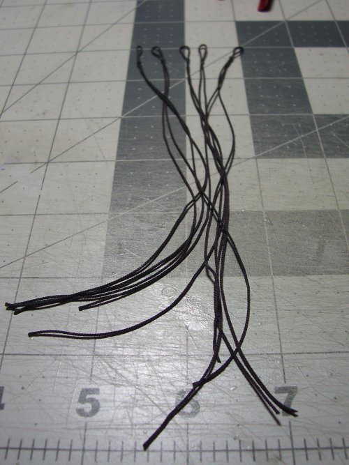

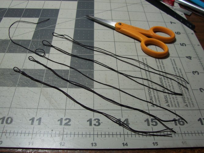

This is the reverse side of the jig and lanyard. You leave the rope long to enable it to be used for seizing if required. If not, it can be threaded through the shroud and dead eye, and cut off.
I made some boards to wrap the line around to keep it from get all tangled up :laughrolling:

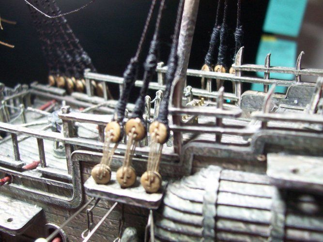

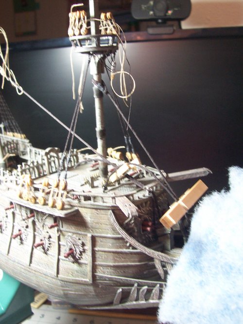

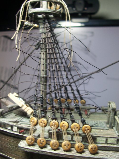

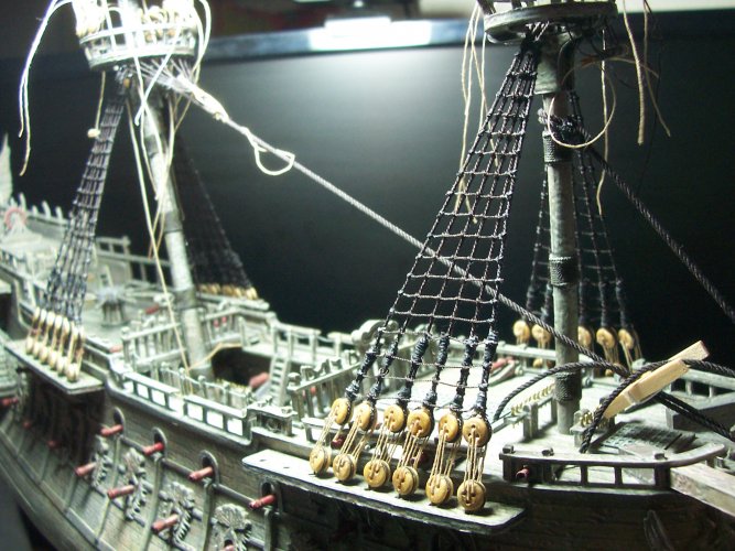

This is the view from the starboard side of the ship at the front foremast lanyards in place for the shrouds only.

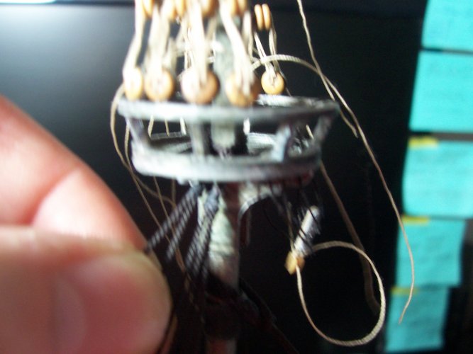

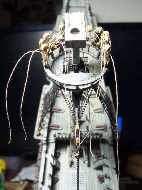

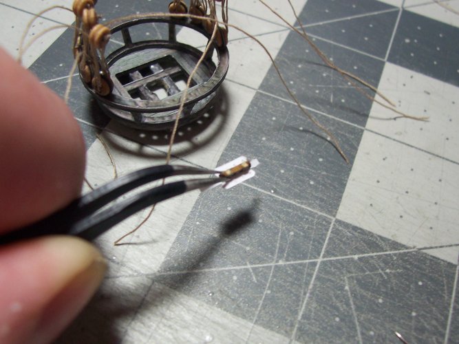

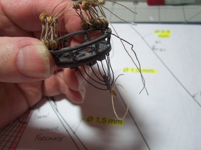

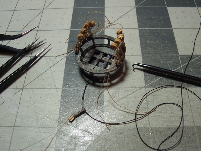

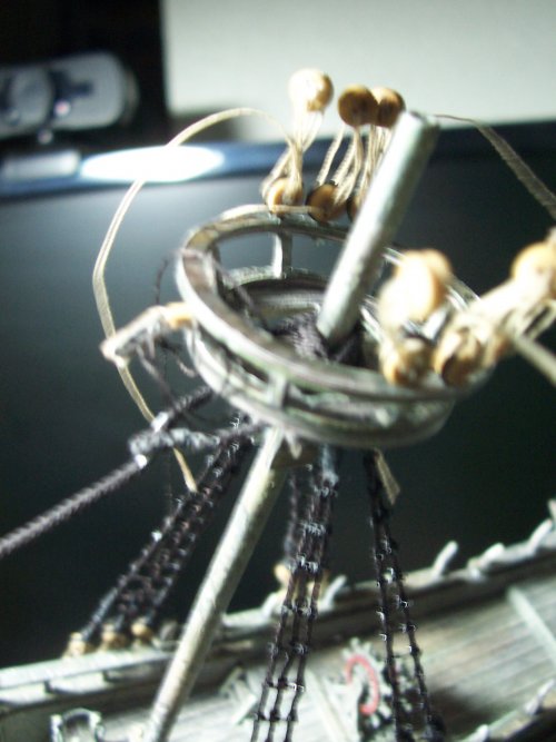

The 2 eyelets that will be inserted into the bottom of the foremast crow's nest.

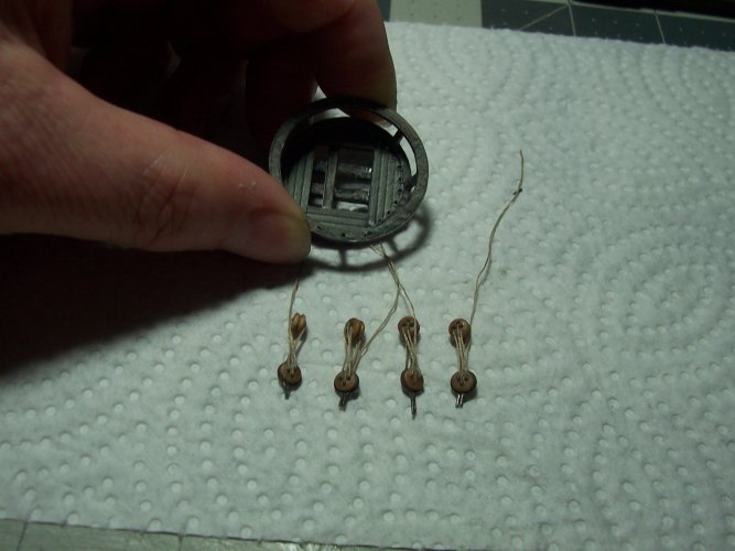

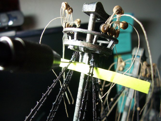

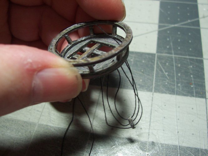

These are the lanyards made for the rim of the foremast crows nest.

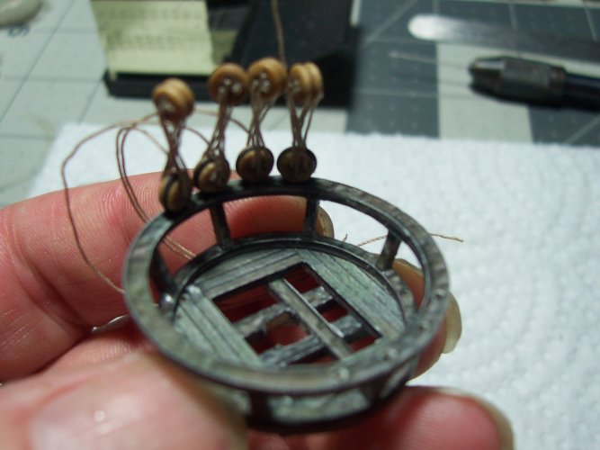

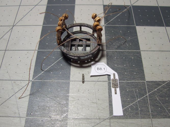

Foremast crow's nest assembled off the ship for ease.

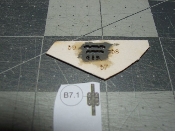

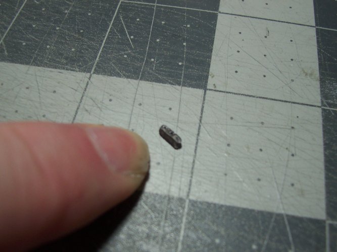

The foremast euphroe B8 and B8.1

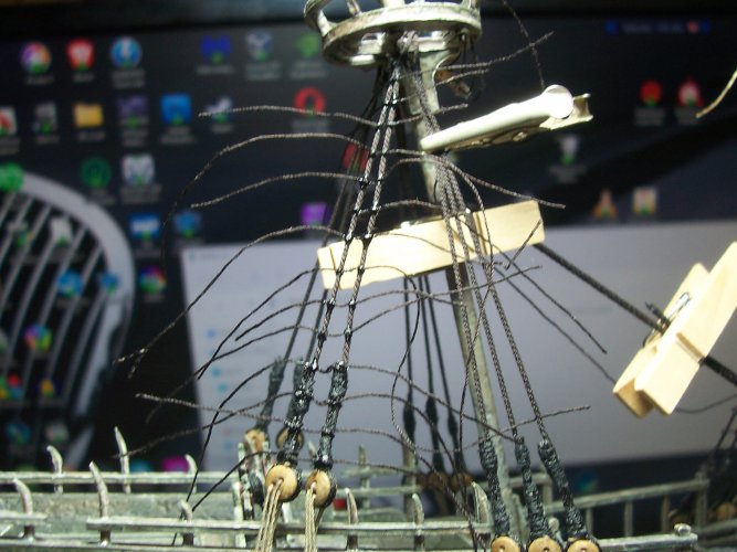

These are all the lower foremast shrouds. These are made of 1.5mm standing rigging rope.

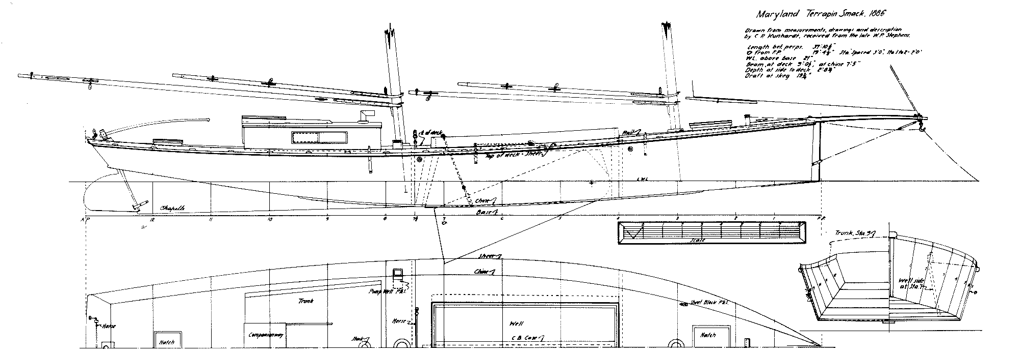

I 3D modeled this Terrapin Smack, I've always wanted to model it. I may have lost the model in my last computer crash. Easy enough to do again with this picture. This type of boat has quite a history. Many boats like this that deserve attention, look great, and would give you the satisfaction but not consume so much time and labor. You could even scale a few to accompany your masterpiece. :)
Check out this link: https://www.gutenberg.org/files/29285/29285-h/29285-h.htm
Terrapin Smack:

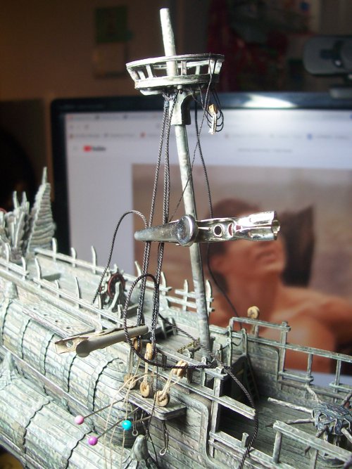

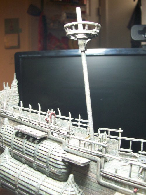

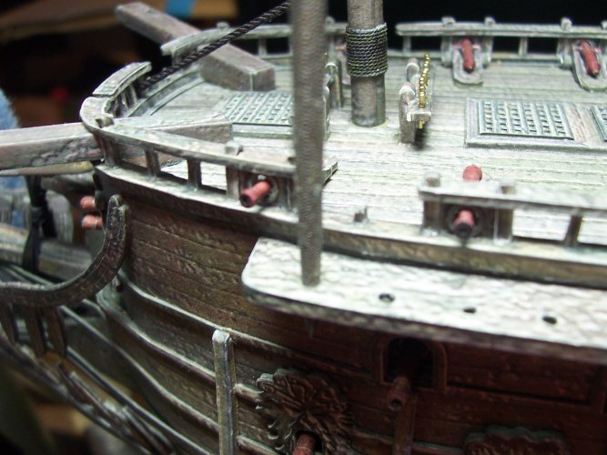

There is an angle to the mainmast, and mizzen on the Flying Dutchman. This is called the 'rake". This is where the masts lean slightly to the stern of the ship.

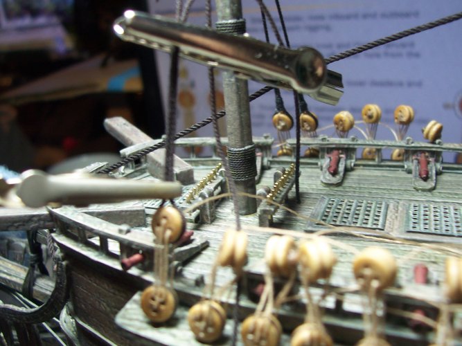

Time for some more dead-eyes and lanyards, this time on the port side of the ship. We started on the starboard side, then over to the port, then repeat until done. The large croc-clip holds the ropes tightly, while the smaller clip nips in where the ropes loop around the dead-eye. Then some CA glue to the rescue. They are 5 mm deadeyes on the lower foremast same as the lower mainmast.
Here we go a seizing.

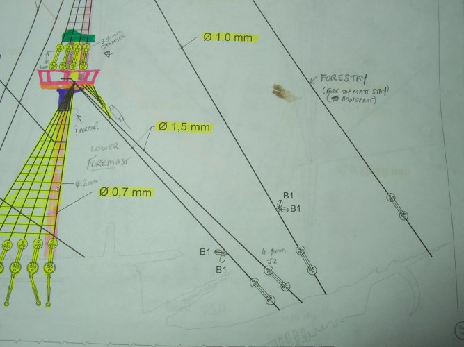

Trying to figure out the main and fore stays. The padded stuff is around the front of the ship is to protect it.

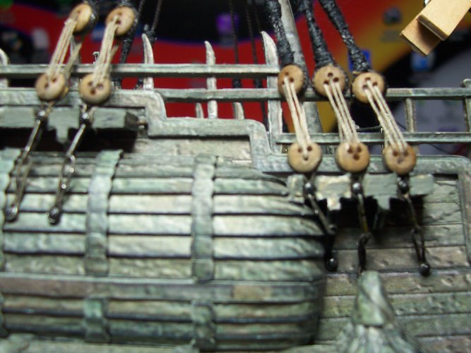

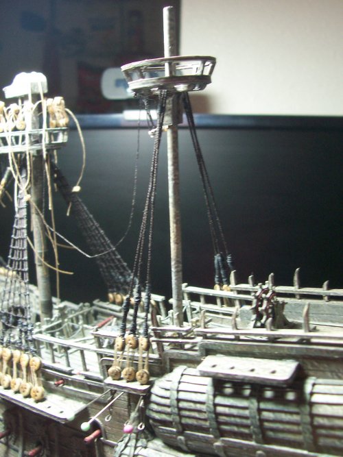

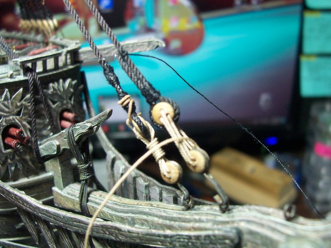

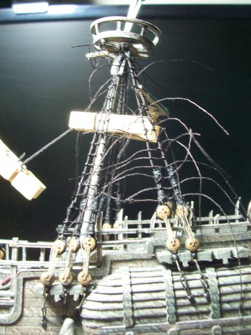

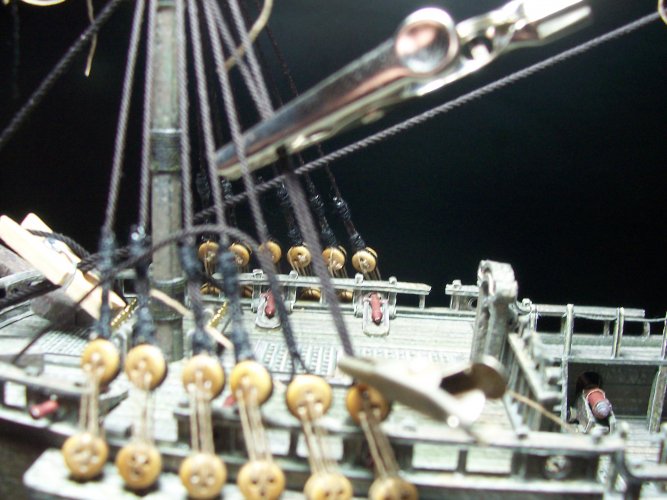

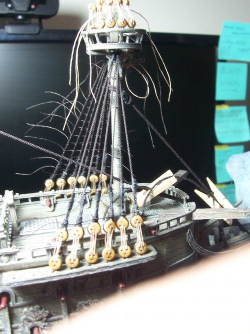

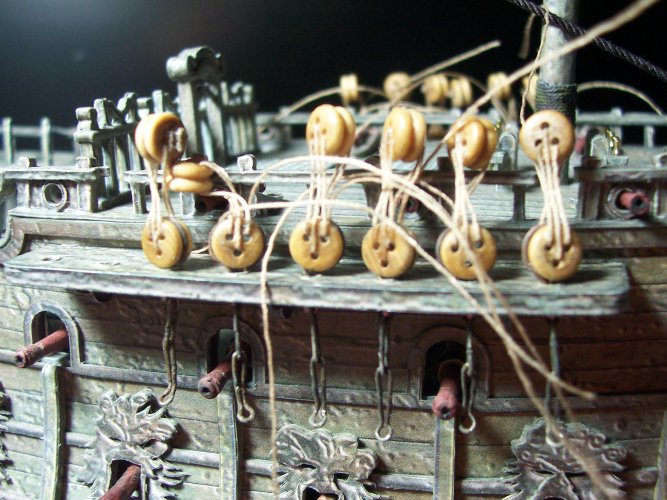

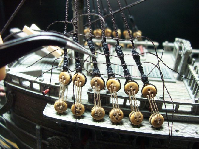

Nice and clear pic of the starboard lower foremast deadeyes.

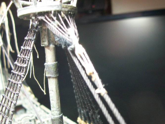

A view of the upper end of the shrouds.
Being able to take off the shrouds off the ship makes it easier to perform the seizings.
WOW! Another clear picture that should help a new builder.

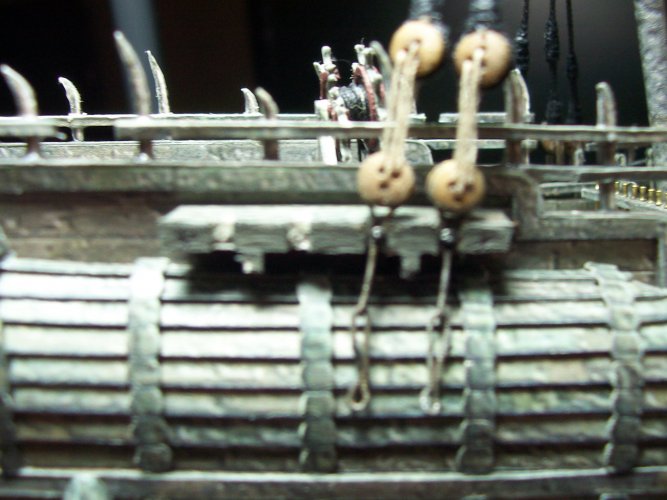

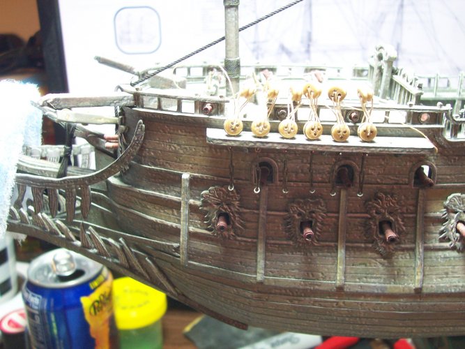

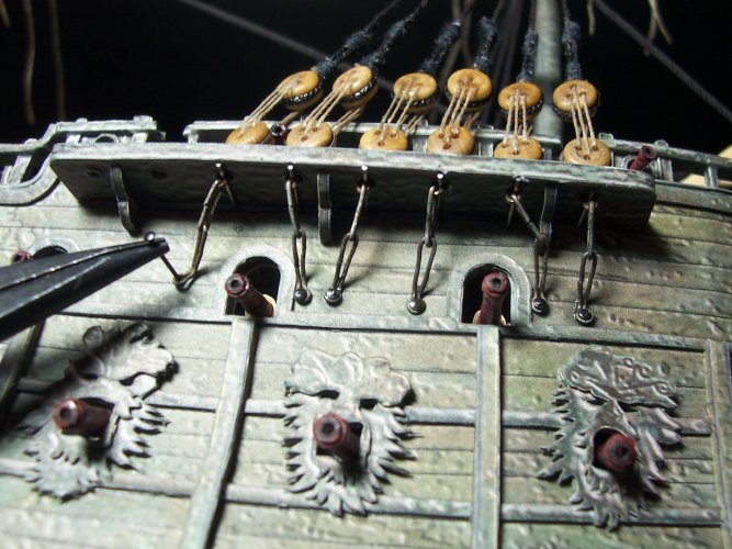

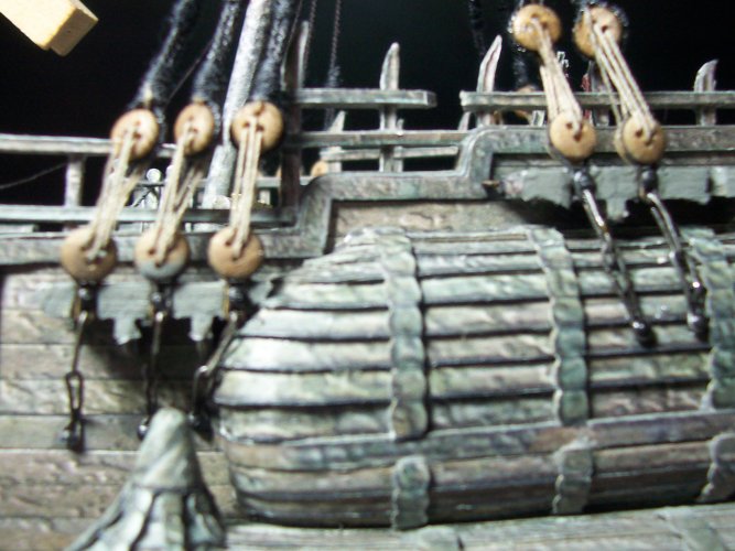

Aha, this is the chain plates for the lanyards. I used some CA glue on the cannon barrels to give them more strength.

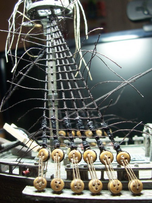

Clove knots! Lots of them.... like hundreds and hundreds of the little buggers :animated: :animated::animated::animated::animated:You will need to get used to tying these using 2 pairs of tweezers surgeon style.
It looks like a rats nest. I was looking at the size needed for the ropes of the ratlines. They say that the ratlines should appear invisible when looking at the ship from a short distance. I used 0.2mm. Hey, get your finger out of there!!!
All of my hard-work :violin::bulgeeye:
Put a dab of CA glue only on the end knots to help it all stay in place. Its okay if they are a bit slack to get a 'swagger' effect to the ratlines.

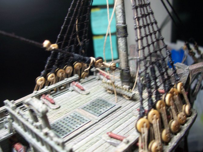

A view of the lower foremast standing rigging.

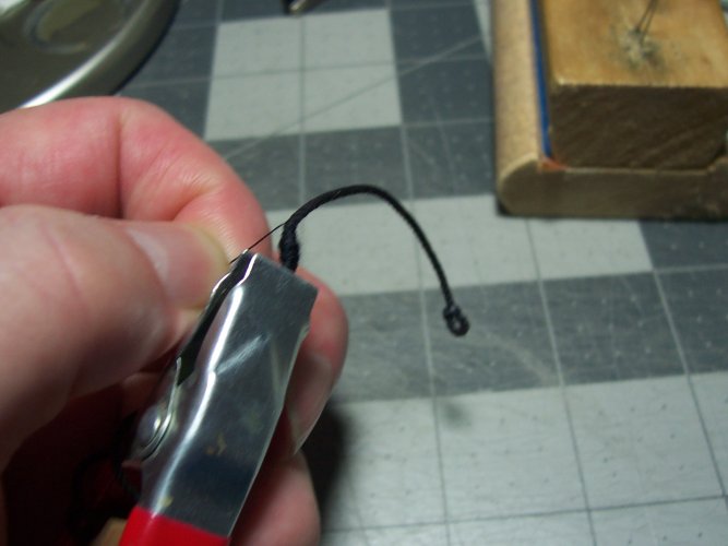

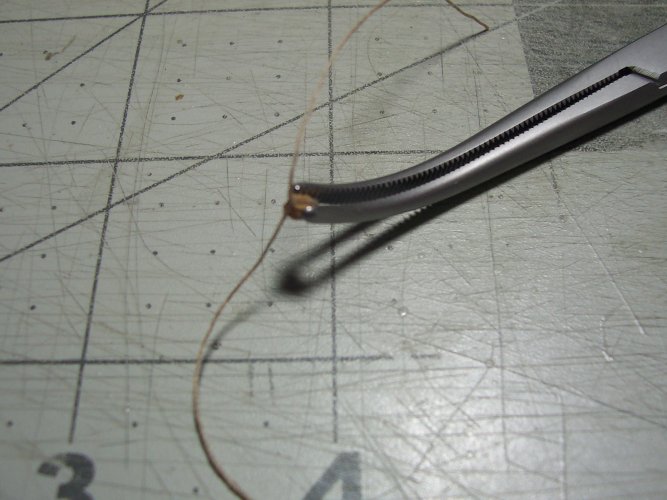

Here is a mouse. I made this one using a thin twine wrapped around the rope. I marked the rope using a tint dab of white paint on the rope for where the mouse needs to be located.

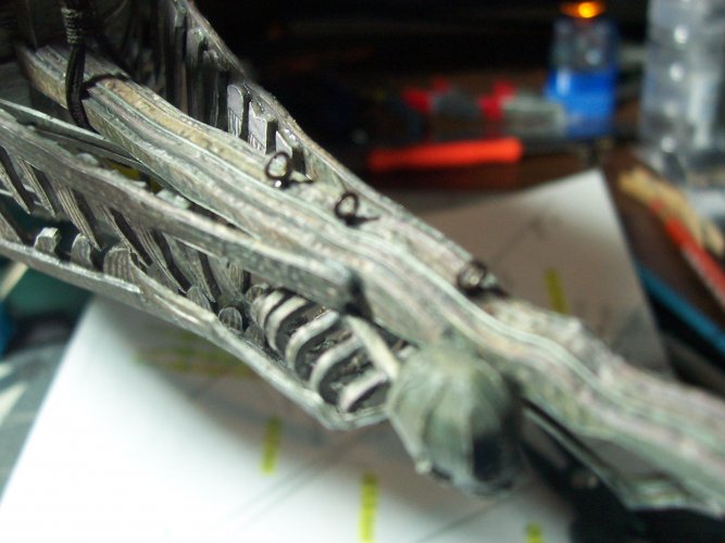

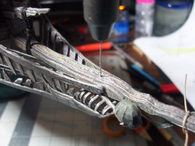

Here I am drilling some tiny hair like holes through the bowsprit for the needed eyelets. I found that this is the way its done for this ship by very carefully examining the pics zoomed in.
Slightly larger diameter eyelets CA glued in place on the bowsprit.

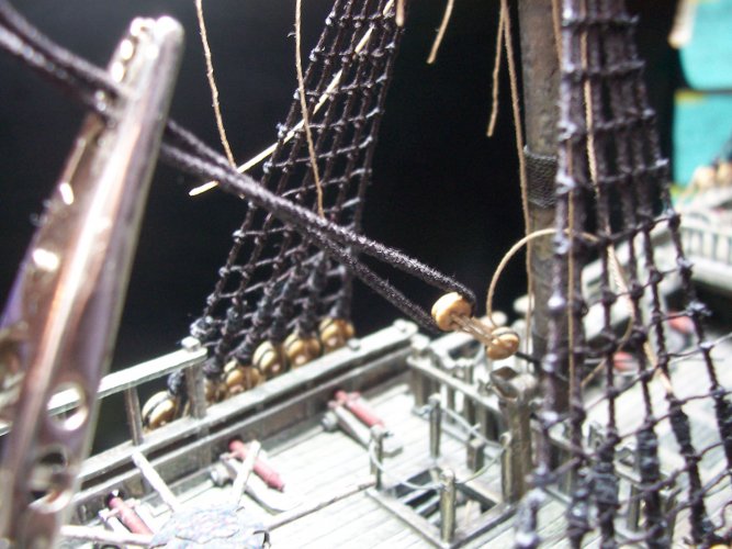

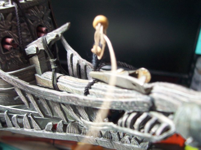

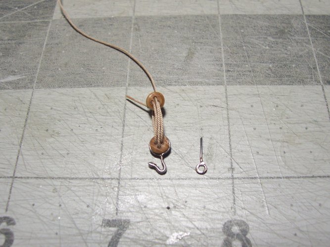

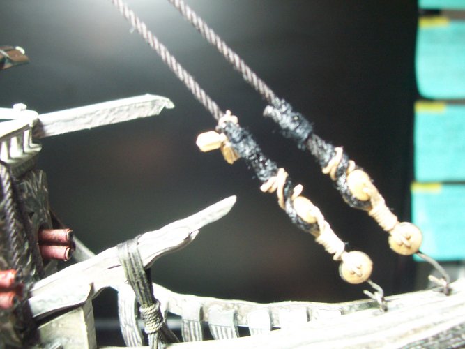

I created a custom strop for the lanyard that incorporates a hook at the end.

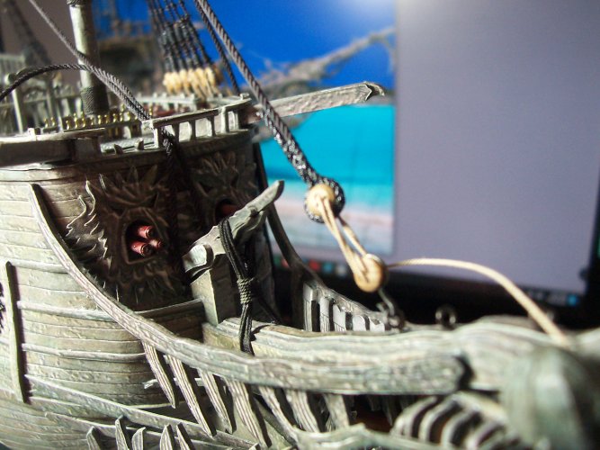

Hooking the stay from the foremast into the eyelet located on t he bowsprit.
Time to do the seizing around the rope.

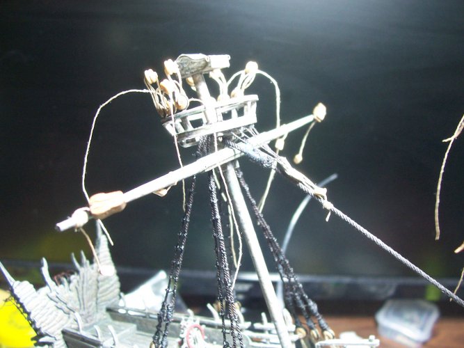

The crows feet of the foremast.

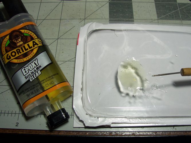

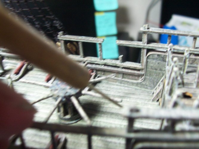

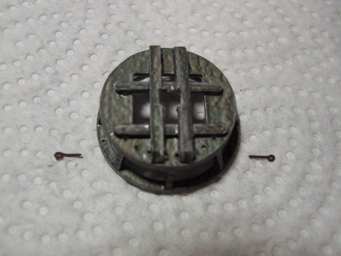

Plugging Ends of Capstan Arms​
I mixed a bit of 5 minute epoxy to push into the ends of the tubes for the capstan. It was bothering me that the ends looked open!
I just used a needle to push the epoxy into the ends, and then painted them with pewter colored acrylic.

G1 and G2 are a little different and it matters! Just be careful of the length of the strops.

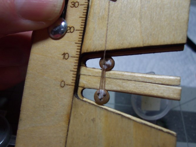

The jig is VERY useful for making the lanyards accurately.

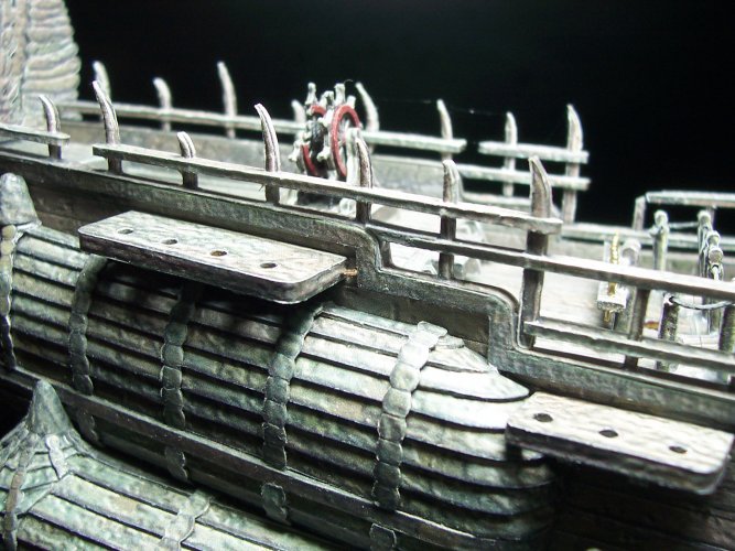

The thickness is greater for the channels for the mizzen than the main and foremasts.
I decided to cut the channels in half to make the fitting of the chain plates more accessible. This was the way it was done on ships in fact.
Now, the strops for the chain plates can be easily pinned and glued to the channel wales.

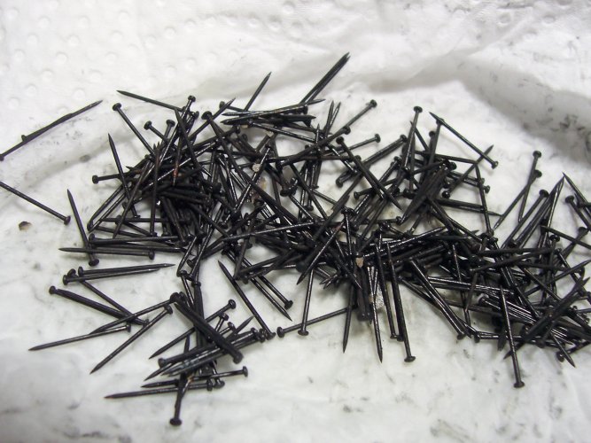

I just dipped some tiny nails into my acid solution to make them patina black finish.
The nails hold the chain plates securely to the sides of the ship and just a dab of CA glue to really hold it all together.

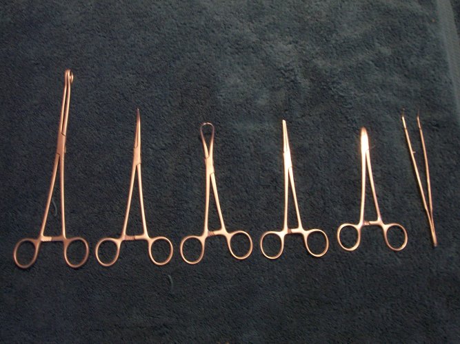

A friend bought me a set of surgical tools for working on my ship. They are very useful!

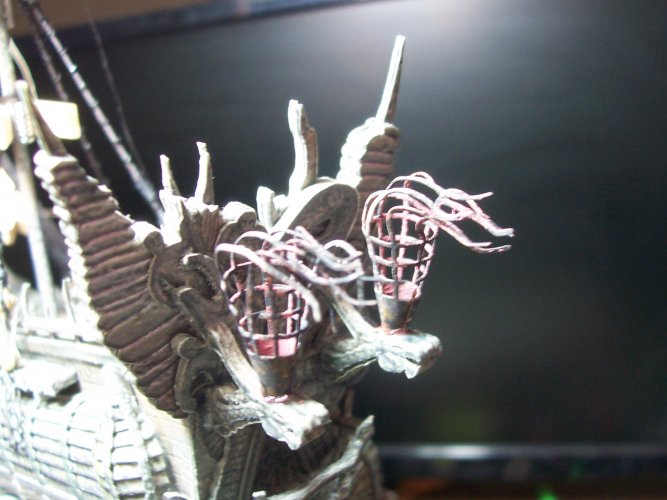

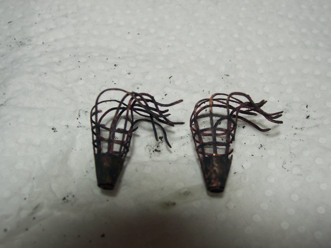

I decided to re-do the lanterns at the back of the ship. I didn't like just the chocolate brown paint job.
This is the new, finished results of dipping them finally in the patina black acid. Now they look nice and old.
Much better I feel!

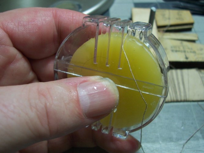

I got some beeswax to coat the ropes for all the rigging. It has many advantages such as preventing knots from undoing, and making the ropes resistant to contracting / expanding through damp / dry weather conditions.
