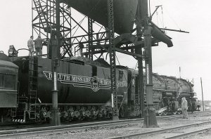

Tell you what' though i love my Akane it looks almost primitive compared to the Westside detail wise.
Not the best shot but the only one i have here at work but you'll love the 2nd shot....heh'heh

A'yep...All things must come to an end i guess....Oh' i'm not ashamed of my Akane it runs like a swiss watch and will pull just about anything i hang on her tender'....just wish it had a Vestibule like the westside.
One day soon i plan on installing a Tsunami heavy steam decoder in it ...maybe after i retire.
For Xmas got the DVD of those Yellowstones working around Proctor in the mid -late 50s' Only thing wrong was it was only about 30 mins. long but what a show they put on.:twisted:

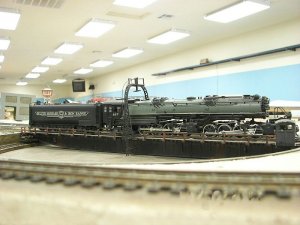

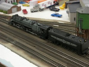

Yep' she's a pruty one! heres a better picture of her taking a spin on the turntable on our club layout.
As Kevin says,it's a beauty!I actually just bought an Akane Yellowstone,lets just hope it's still in stock!

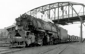

Oh' and heres the rest of the pictures i was able to find on the net.
