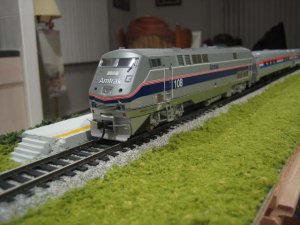

Over the past weekend, I found some free time to experiment with using latex caulking to lay roadbed, track, AND ballast all in one shot, described in this thread: http://www.the-gauge.com/showthread.php?t=25413
Anyway, the commuter station module has come far enough for me to start taking some test photo shoots, and here's the result.. I gotta say I'm REAL pleased with how the method turned out. :thumb:
So the photo.. An HO-scale little-person railfan catching an Amtrak train pulling into the station of the fictitious Hudson Valley town of Tappen Landing, looking snappy for the traveling public!

To remove anything held in place by caulk:
1. Take a sharp craft knife and cut along the seams.
2. If needed, use a putty knife to seperate underside of object from base.
3. Turn object over and peel off the caulk. It peels quite easily. Any residual traces can be removed with warm, soapy water and a small brush.
Nice photos, LIT - and a beautiful train.
Miles:
I was surprised how well the caulking held everything together. As Mountain Man says, you can indeed pull up the cork roadbed or the track by using a putty knife fairly easily, but that latex caulking holds on pretty darn good. :thumb:
The biggest benefit I'd say would be the time savings. The module is 4 feet long, and in the past when I did things the old-fashioned way for a similar module, it takes DAYS... Lay the cork roadbed using Liquid Nails, wait a day for it to dry... Nail the track down temporarily, spread the ballast, and then painstakingly eye-dropper the Elmers/Wet Water mix, and then wait another day for it to dry...
This one took me all of half an hour, from the time I laid the cork roadbed to finishing the ballasting. :eek: And yep the ballast roadbed contour has me as pleased as punch. :D

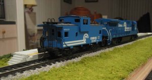

Another photo.. "Hi-Ho Escargot!" Our intrepid HO-scale railfan caught this Conrail B40-8 and caboose making a non-revenue run back down to the Pelham Yard in the Bronx, 20 miles away.

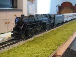

Another test shot.. NYC J1e Hudson #5330 on an imaginary fan trip. (Yes, I know there are no surviving NYC Hudsons.. But I gotta have at least one steam engine on my pike!) :D

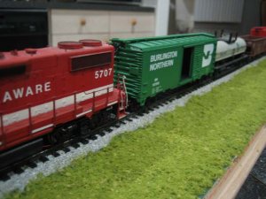

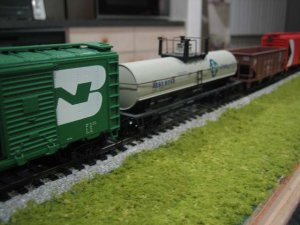

The turf is Woodland Scenics Green Coarse Turf with some Yellow Grass sprinkled in. This looks closest to the kind of turf I see in Upstate New York. And yes, I know I need to work on getting a backdrop! :D

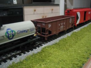

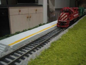

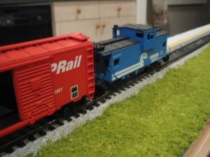

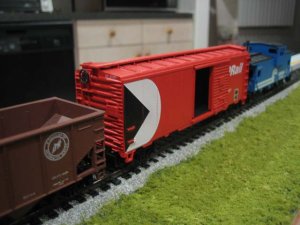

Anyhoo.. Another test shot, this time a roll-by.. My freelanced Delaware System has trackage rights over the Tappen Landing line. The GP38-2 is the most numerous loco on my roster because they handle tight curves on my tiny pike so well. That's my 20-year-old custom-detailed-and-painted Athearn unit. :cool:
