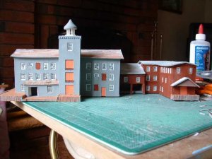

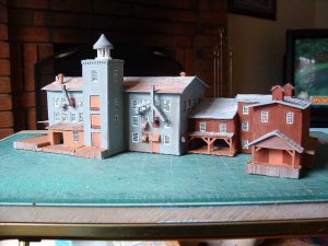

This mill is progressing slowly. Here you can see a bit more done.

I'm very impressed.
I just wish I could reach through my computer screen and grab the model!
I see what you man by basing the measurements on other scaled models and working it out that way.
The clothes pegs, yes us Kiwi's call them pegs, maybe its a British thing? Its a greta idea, cheap clamps! BRILLIANT, I shall have to remember that for the future.
How did you create the window frames Robin? They look great.
Also what material did you use for the roof tiles and the siding around the entrance (hope you know the area I mean)
Great work!
Jason
Thanks again folks for the kind words.
Jason, the window frames start with paper strips glued around the back so 1/32 strip shows. I then glued window screening behind that . The window screen comes in black so dry brushed them with white acrylic crafters paint. I filled in some of the frames with the white paint too. The roof shingles are strips of paper . The siding I think you are reffering to is 1/16th strips of cerealboard.
Amazing!
I thought you may have made the window screens as well!
Now that would have been difficult and time consuming.... and somewhat frastrating!
Its amazing what you can do with cardborad and paper.
as the paper ages will it curl and deteriate?
Yeah the siding bits I meant were around the loading bays and entrance areas.

Robin keep up with those pics!
Cheers
Jason
Jason, the 1/32 is 1 32nd of an inch. So far paper has stayed where I put it without curling or deteriorating. No sunlight hits it in my basement so it's protected that way. I also set the humidity at between 30 and 50 percent through the furnace in the winter and the aircondtioner in the summer so that all helps. Now with the cost of electricty skyrocketing here I may not use the airconditioner as much as I used to. We have also been asked to conserve electricity too.
Robin, the external vents are so cool. That's another wonderful building for your collection of wonderful buildings. You are the Bob Ross of paper.:D FRED
